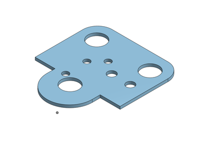

We need a mount that is going to fit our printers mounting plate so let's design one. If you are using a Longer Lk4 then go straight to Thingiverse and download the Lk4 backplate.
- Go to Thingiverse and download the blank backplate (Rotary tool mount for 3d printer by puzzleman32 - Thingiverse)
- Import the file to your cad software (I am using Onshape)
- Measure your backplate
- Make a new sketch on the back and put mounting holes where needed for your printer.
- Copy the sketch into a new workspace and extrude it around 5 mm
- Modify and print until it fits your printer perfectly.
- Add the sketch to your backplate then print the backplate and the front plate

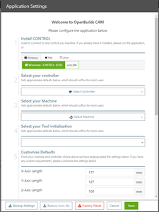

- go to OpenBuilds CAM Gcode Creator - Public Beta
- It should pop up with a application setting menu do not close it
- if you don't get the menu then click on the settings tab then click settings
- Skip to step 5 then put in the size of your wood or whatever you are cutting so the machine doesn't try to cut something bigger than it can handle
- save the setting and go back to this menu whenever you are changing the size of what you are cutting

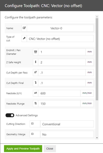

- Now let's create a toolpath so select every line you want to cut/engrave then click add on the right side. (The image shows my engraving settings)
- In the menu change all the parameters to what fits your job
- Click generate Gcode then save Gcode then you are almost ready for your first job.
