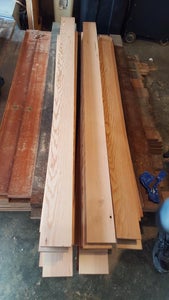

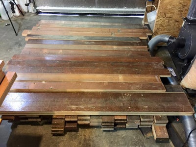

Step 5: Chopping for Manageable Lengths
When I brought these old bleacher wood planks home, I had to take several trips using my church's 12-passenger van. These things were LONG!
Using a friends extending miter saw, I was able to chop these 20ft. long boards down to two 6ft. and one 8ft. boards. This was a no-brainer. I HAD to cut these things down to manageable lengths. This took a LONG time...40-some boards cut down to length.
So now, with a total of 120 boards, next step is to rip them all down to the width of the floorboards I wanted!

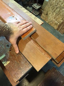

Step 6: Squaring the Edge and Ripping Correctly
So to maximize the number of wood boards from each plank, I would take my 10" wide plank, run one edge through the table saw to square the edge. Then, after I squared the edge of ALL 120-some planks, I ripped 4 & 1/4" wide boards.
Why the extra 1/4" to the 4" widths?
Whatever width you want your floorboards to be, you still have to consider the tongue and groove joint at the edges of the finished floorboards. That's super important, and it takes some forward thinking from you!

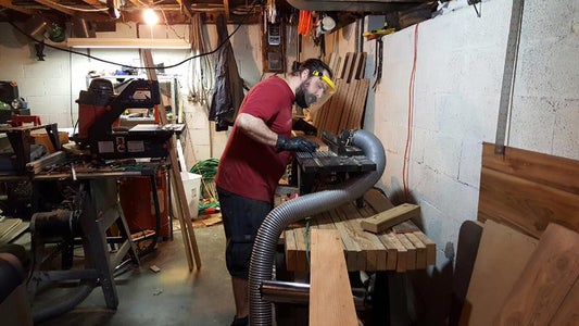

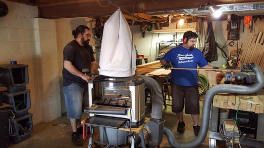

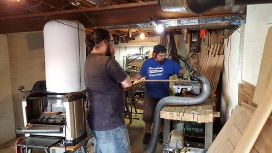

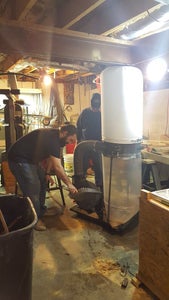

Step 7: Problem With Dust...
So I mentioned in the safety steps of this Instructable that dust is a serious issue when it comes to woodworking. It was at this point in my project that I realized I needed some SERIOUS dust management.
At this point, I was able to sweet talk my wife into getting me a planer for this project...but a dust collector too?
Actually, it was really easy to get her on board with buying a dust collector. She saw the huge amount of sawdust, not only what was collecting on the floor, but the amount just floating around in the interior garage and eventually landing on everything. It was a complete mess, but more seriously, dust is extremely flammable. In certain situations, when it's ignited it could easily be described as "explosive". Too much dust floating in the air can be combustible with a single spark!
Plus, as you can see in the video, it's helpful when you want to get the dust out of your long hair quickly!
So a run to Harbor Freight and for around $250, I was able to get a fairly decent dust collector that did the job very well! After a cleanup job in the shop and assembling the dust collector, our momentary pause in our project was over and we started the next step...

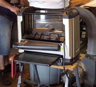

Step 9: Time to Use the Planer!
Planing wood was always my favorite step in woodworking class in high school. Taking the raw cut lumber that my teacher always came across, and feeding it through the shop's GIANT industrial planer was FUN!
One of the huge perks of making wood flooring from scratch yourself is that if you have to buy tools to do the job, it's still going to be cheaper than buying wood flooring from a box store and getting them installed...AND YOU STILL GET TO KEEP YOUR TOOLS! I was able to sweet talk my lovely wife into getting me a tabletop planer that was good enough to tackle my project easily. What a deal huh? Also, this was the moment where I realized that getting the dust collector was a GREAT choice, because wow...those planers sure do spit out wood shavings like crazy!
Fortunately, during the re-sawing phase of this project, I was incredibly careful to make the cut exactly in the middle, so for a large number of boards, there was zero planing needed. Only about 20-some boards came out thicker and needed some planing done.
And once again, I didn't get any photos of me and my friend doing some planing! Honestly though, with only a few boards needing planed, and the planer actually makes quick work, there was barely any time to take a picture. However, there is a photo of some boards sitting next to each other showing the before and after!
Just secure the planer to a workbench or a portable stand, attach your dust collector, and off you go!

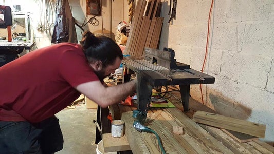

Step 10: Using the Router Table
It's an extremely necessary step, in my opinion, to add a tongue and groove joint to every board to ensure that the whole floor locks together.
This was probably the most mind wracking part of this project in my opinion for a few reasons.
- You have to make a tongue joint on one long edge and one end of the board, then make a groove joint on the other two edges.
- For the remaining boards, you HAVE to make those identical joints for ALL of them. First, you will choose which face of the board you want to be the top of the floors, and then make sure you make the identical joints for all the boards. Don't get confused! I only wasted only 3 or 4 boards, but if I didn't pay enough attention as often as I did, I could have wasted a lot more.
- You have to make sure the fence doesn't shift over time, or let your router that's mounted under the table to drift lower throughout cutting all the boards. Routinely check with a metal ruler that your measurements haven't changed!
Also, remember in Step 6, "Squaring The Edge And Ripping Correctly", that I mentioned the extra 1/4" to the width of the boards? This is why - My tongue joints was exactly 1/4", where the grooves joints were also 1/4" deep. After a board was fitted into it's adjacent board, there was exactly 4" of board exposed. This is where planning is crucial! If I hadn't thought of this, I probably would have ripped only 4" wide boards, and overall had 3 & 3/4" wide floor boards. Not an extremely terrible thing, but in the end, a 4" board to a realtor or home inspector would appear more professionally done then something that looks accidentally wrong.

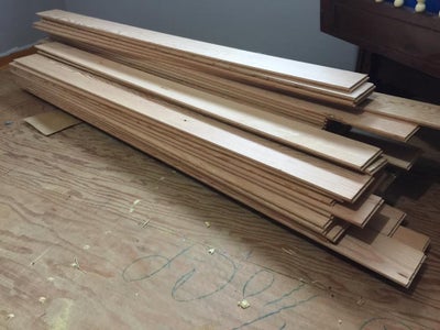

The next step was to move the new floor boards into the nursery and let them rest for some time.
Why? Well just like I mentioned in Step 2: "About the Wood", you need to make sure that the new boards have adjusted to both the temp and humidity levels of their final resting place, the nursery (or whatever room you may be working on). Moving the boards into the room and letting them rest for at least a week (in my opinion) made absolutely sure that the majority of the expanding or contracting was done beforehand, and not AFTER I had nailed them down. This isn't too necessary for smaller rooms, but the larger the room, the more imperative it is that you let the boards relax to the room's average temp and humidity.

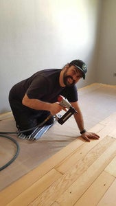

Step 12: Vapor Barrier and New Floor Boards!
You just HAVE to protect these new wood floors, both from above and below! We have a semi-finished basement, so the plastic vapor barrier wasn't very necessary, but I opted to put it in anyway.
A vapor barrier can either be the official product, or in my opinion, just buy 6 MIL thick plastic sheeting from the box store. It's exactly the same thing, but $20-some less. With the cleaned sub-floors, the vapor barrier, and a staple gun, I laid down the vapor barrier, adding an inch or two excess around the edges. I also decided to use packaging tape to seal over the staples, to hopefully make the whole barrier completely vapor proof. If I didn't use the tape, I still think it would have been okay without it.

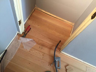

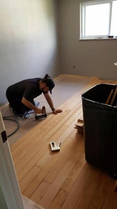

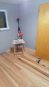

Now the fun part! Even my preggo wifey got in on the action!
Using a scrap 1/4" thick piece of wood, I perfectly allowed some space between the wall and the first row of boards to allow for expansion. A special note about this first row...it HAS to be perfect. Anything that isn't fitting square or straight will show and magnify in the next row, then the next, and so on and so on. Find your straightest, flattest boards, and use them as the first row.
With that said, you should try your best to make sure EVERY row of wood boards is nailed down as straight as possible, and you may have to be creative to wedge, pull, push, and clamp those boards tight against the previous row before you nail them down. I had to use a variety of techniques to do this from using long wood clamps, to even using screws in the sub-floor to push a board tight up against the other boards. I made a moderate effort to keep things straight, but in the end, I wanted character in the flooring too, so a minor gap here and there in it wasn't too concerning. In a later step, you'll see how I fixed those small gaps!
Using an air nail gun is practically imperative at this point. I would HATE to use a regular hammer here; it would prolong one of the more fun steps of this whole project and you would undoubtedly become frustrated quickly. I borrowed my father's air compressor and bought my own nail/brad gun. Don't go crazy with the thickness and length of the nails by the way; They only need to get through the thickness of your wood boards and the sub-floors. Just use some common sense with the length of the nails, but keep them as thin as you can to properly do the job.
Also, the power miter saw is needed for this step. You'll likely have to chop down a board to make the exact fit for the last board of every row, and having the saw in the same room makes things easier. Just remember, keep that dust out of the air as much as possible with plenty of ventilation! One more thing: keep in mind for expansion, and don't cut the board so that it's all the way to the wall. Keep at least 1/4" of a gap between all outside edges of the room and your floors will be a happy camper! This is especially important for larger rooms!

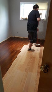

Step 13: Sanding, Sanding, & MORE Sanding!
This next step is where the large wood sander came into play. I opted out from using a belt sander here, as it can easily ruin your work with large gashes! Instead, I went to my local tool rental shop and got myself a floor sander with the grit paper they recommended. These guys will likely know what you need, so take their advice when they give it!
Before you begin sanding, there's a few things you need to do first:
- Dust. You know exactly what I'm going to say if you read this Instructable so far. You HAVE to plan on getting rid of airborne dust and bringing in fresh air, and you MUST ALWAYS wear dust masks. The better the mask, the better you'll be. Also, you'll need to seal off the room from the rest of the house so that the dust doesn't get anywhere else or in the ventilation. This means closing and sealing the door AND closing off any air duct vents and return air vents. I don't care how you do it, just seal off the rest of the house!
- Nail Heads. Make sure you don't have any nail heads protruding from the surface. My air nail gun would sometimes misfire and not shoot the nail head below the surface, so my first pass over the floor with the sander was partially unsuccessful due to a few nail heads tearing up the sand paper.
- Work quick! When I rented the sander, I had an unusually long weekend with Memorial Day on Monday, so I made a deal with the rental shop to have the sander on Friday, Saturday, Sunday, AND MONDAY for the same weekend price...sweet! But I needed ALL of that time with the sander to do the next few phases of my project. Plan ahead, or you'll pay the price!
Your sanding technique will need to be pretty good with the floor sander, but if you get an oscillating version of a floor sander, it's very forgivable if your technique isn't too good. Basically you'll want to move the sander only when it's actively turned on and vibrating, AND you'll want to work in loops and figure 8's with some overlapping on the next few rows of the wood floors. The sander will vibrate the heck out of you, so only use as firm as a grip as needed, so your fingers will take the beating, and not your shoulders and back. You'll feel this sander's punishment the next day! If you have gloves, use them, especially the ones that have extra padding on the palms and inside finger areas.
Sand the whole floor, then sweep and remove the dust from the whole area. Once the dust is collected, do another pass again, then collect the dust. Do both the sanding/dust collection as many times as you feel you need!

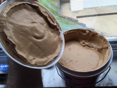

Step 14: Liquid Wood Puddy and MORE SANDING!
I REALLY wish I had more photos of this next step. Sorry, everyone!
Most likely, if you are making wood floors from scratch and reclaimed wood, you won't have perfectly fitting boards with zero tearout from your power tools. Also, in my case, the reclaimed planks I took from the bleachers had bolt holes drilled throughout them everywhere, but I truly didn't mind these flaws, nicks, and imperfectly assembled boards! To me, this added some lovely character to my final floors, and once I stained the whole floor, they were BEAUTIFUL with all those imperfect spots; However... You'll still want to fill in every hole, gash, and seam at least some!
If you use your regular kind of wood putty from the box stores, you'd be dedicating DAYS to just filling those gaps, but I don't have that kind of patience nor the time. I only had ONE DAY to apply the liquid wood putty, so I had to use something fast! Enter the liquid wood putty!
I ordered my stuff from online and it came a week before I needed to apply (planning is key!), and it came pre-mixed to what I needed in color and consistency. With a wide, plastic drywall trowel, I was able to cover the ENTIRE floor in about an hour.
In this video, they show the exact kind of technique I used to apply the liquid putty. (*Note: this isn't the putty that I used*) With the back and forth motion, I was able to cover the whole room in less than an hour, with minimal amounts of putty...I'm pretty sure I have enough for the other two rooms!
After applying the putty and letting it dry for a few hours, I was able to get the floor sander out and clean it all up! This left a completely level floor without any gashes, but left the visuals of an imperfect floor, full of character! Be extra careful here with the putty being sanded. This part kicked up a large volume of dust, more than ever before!

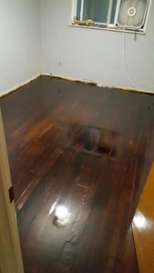

You BETTER HAVE SOME SERIOUS VENTILATION at this point!
Staining is no joke with the fumes that it expels, and plan on ventilating that room for SEVERAL WEEKS after you're finally done with the whole project. Fumes from staining and polyurethane will linger for a very long time, and even when you don't smell it, it's still there. For a newborn's room, it's highly recommended having the room ventilated for at least a month after you stop smelling it, so that's like 2 months completely aired out.
Finally, a note about stain: you should only stain a number of coats that visibly is good for your choice of darkness. I'm the kind of guy that goes by what the book says, so when I saw on the stain's instruction label that you should do 2 coats, I did exactly that and had an obviously darker shade. I was actually very happy with the shade with one coat, but I did what I was told and it made the floors DARK! However, I was still very happy with the stain with two coats, so no big deal. Just be aware and coat to the darkness that you like!
Step 16: Polyurethane
After the final coat of stain was dried enough to walk on without leaving marks, it was time for the polyurethane. With an abrasive pad on the floor sander (similar to the coarseness of steel wool), I lightly scuffed up the last coat of stain, just enough for the polyurethane to have something to grab on to. After using the vacuum to get all the dust up, I started to apply the polyurethane with the same tools used for the stain.
Now, here's where I messed up, and hopefully, you will avoid this mistake. Do yourself a favor and do AT LEAST two coats of polyurethane!
My mistake was this: The stain was a stain/polyurethane combo mix, and after doing two coats of the stain, I thought that by doing just one coat of polyurethane, it would have been enough. I mean sheesh, it's "practically three coats of polyurethane!" I reasoned with myself.
But dang, do I really wish I had done at least TWO coats of polyurethane - three preferably to be honest.
However, I'm not totally dismayed. Even though I lost that window of time to apply a second/third coat before the baby comes, I'm predicting that I'll be able to get around to laying wood floors in the 2nd bedroom in about two years. With the large area rug we have in the nursery now, the flooring in the nursery will take just a little beating, and when I'm ready in two years to stain and polyurethane the 2nd room floors, I can move the then 2-year old and my wife downstairs temporarily while I reapply more polyurethane to the nursery floor AND the 2nd room.
Not all is lost I guess!

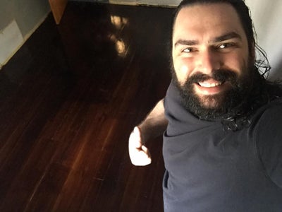

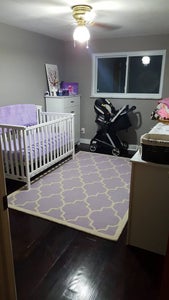

Step 17: Extra: Showing Off the Finished Nursery
This isn't necessarily a step to the floors, but me showing off the rest of the finished nursery!
I'm so proud and excited with the final look of the nursery. My wife and I seemed to have tied the whole room together with the white trimming, ceiling, and furniture; with the medium gray walls, we can use things like the curtains, rugs, blankets, picture frames, etc to add color and make it gender neutral. That way, if we decide to have another kid, we may use this room for baby #2 for the nursery again, and move out our little girl to bedroom #2!
