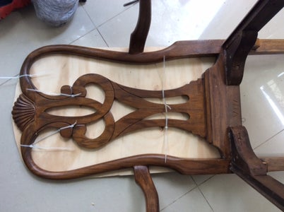

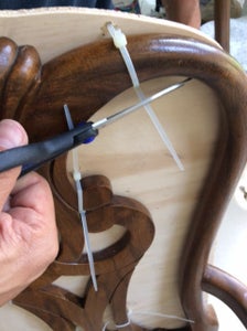

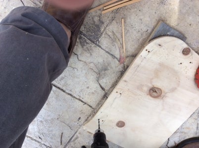

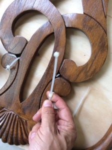

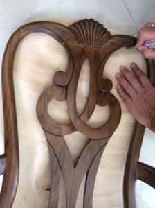

Step 2: Attach the Panel to the Backrest

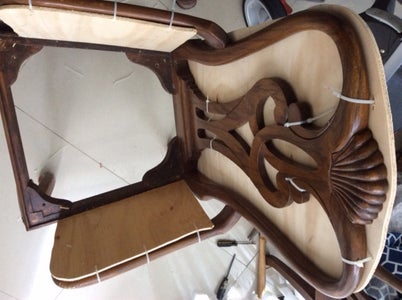

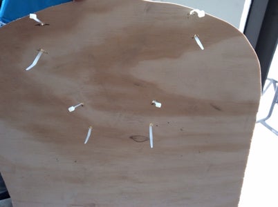

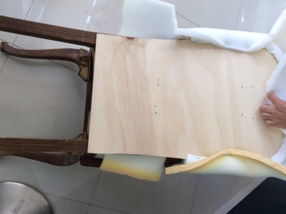

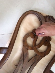

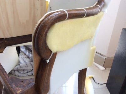

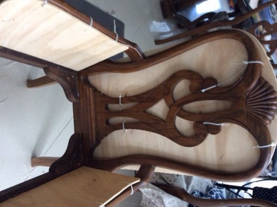

I cut a piece of wood the size and shape of the backrest. Then I made some marks with the pencil to drill and attach zip ties.
I also marked where I want the buttons and drilled those too.

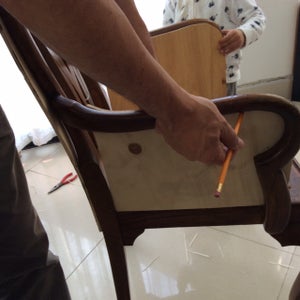

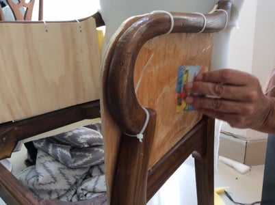

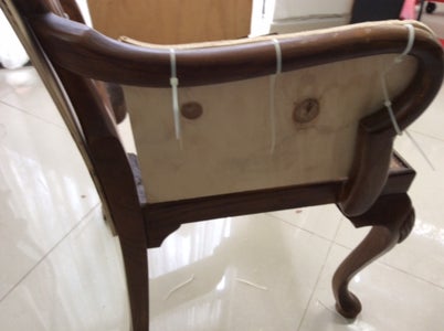

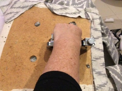

Step 3: Attach the Panel to the Armrests
I also cut two pieces of wood to cover the armrests and also secured them in place with zip ties.

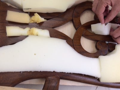

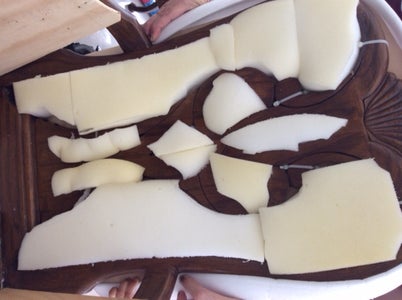

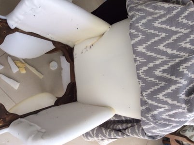

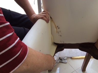

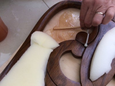

Step 4: Glue the Foam

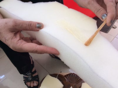

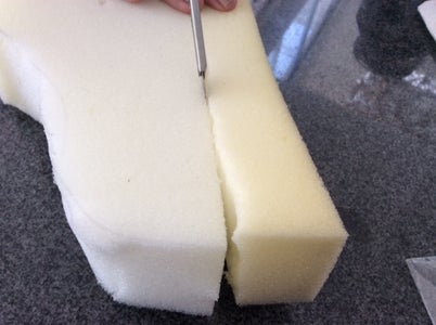

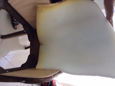

To cover the backrest with foam, I had to cut several pieces of 1 in foam to fill the spaces between the original wood. I used upholstery glue to glue the foam to the backrest.

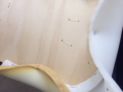

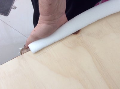

Step 5: Staple the Foam

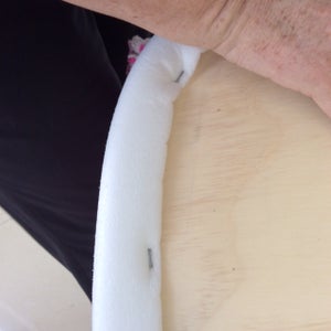

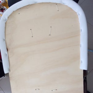

To give it a more professional finish, I stapled the edge foam at the top of the backrest.

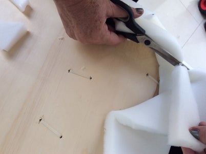

Then I used a thinner foam to cover the backrest at the side that will have contact with the body, and stapled it at the back.
Then I cut all the extra foam.

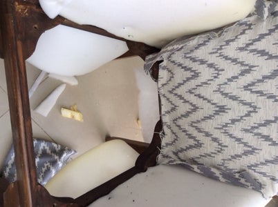

Step 6:
The foam for the armrests was easier. I glued one or two pieces
I put the fabric on
top of the armrests and marked where to sew it. I chose a fabric that is not too thick so that I could use my regular sewing machine.
of 1in foam and then cover everything with the thinner foam. This second layer of foam is stapled to make it tight.

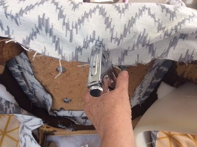

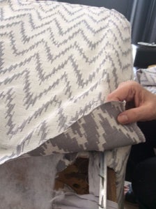

Step 7: Cover the Backrest

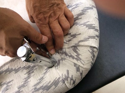

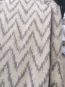

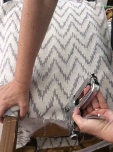

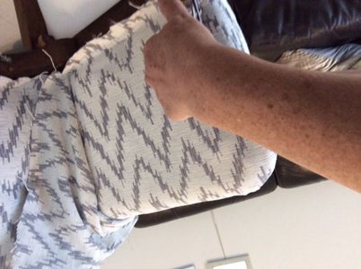

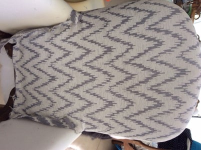

Then I started covering the backrest with the fabric. First I placed it making sure the pattern of the fabric was centered. I stapled it tightly at the back, first one side, then the other side, finally the top.

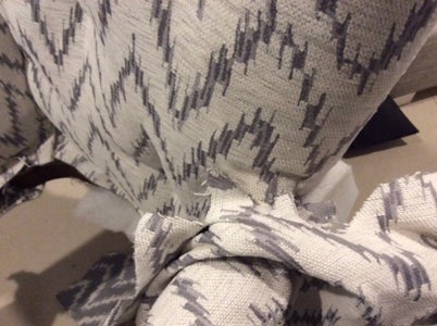

Because it has round corners I made three folds in the fabric and stapled each fold.

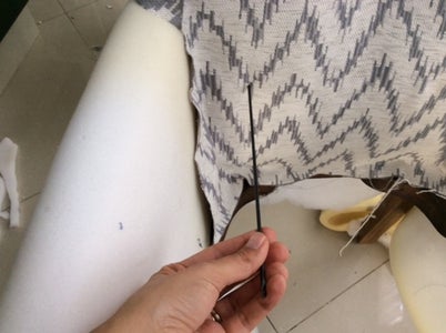

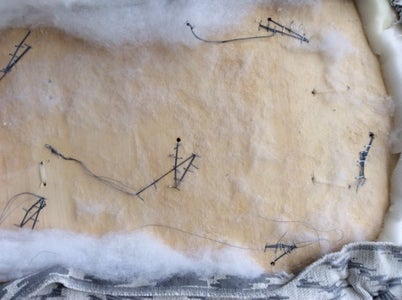

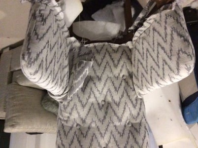

Step 8: Add the Buttons

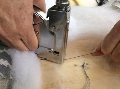

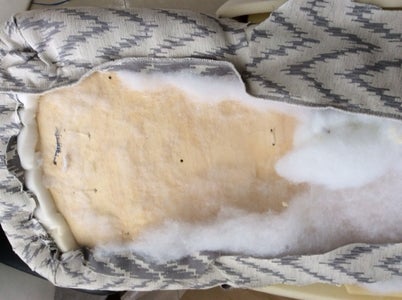

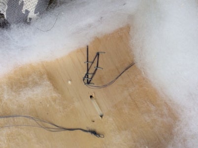

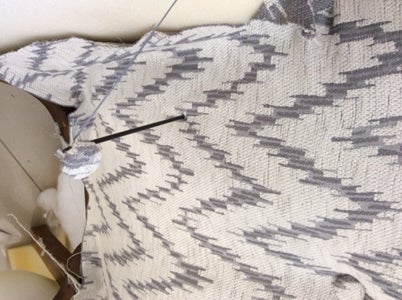

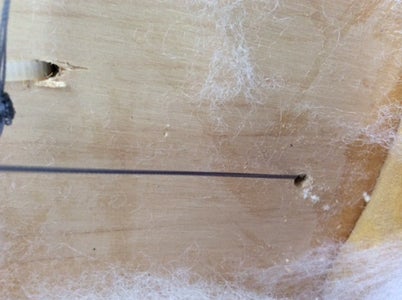

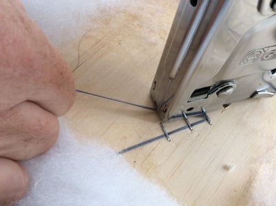

Then I added the buttons. First I used a thin drill bit to manually make a hole in the fabric and foam.
To make them tight you'll have to use a strong thread and staple it at least three times in different angles. As shown in the picture.

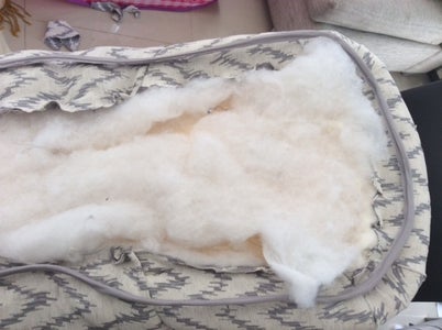

At this point, use the upholstery glue to stick some wadding to the back rest. As you´ll see in the last picture, I made this before drilling the holes of the butons and before covering the backrest with fabric, it was a big mistake. But that´s why you are reading this Instructable, so you don´t make the same mistakes.

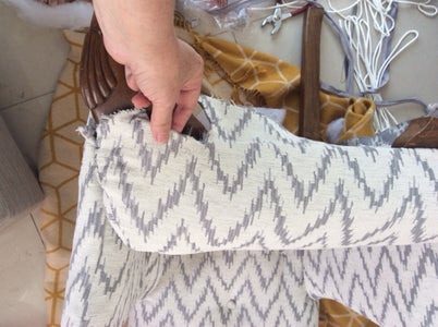

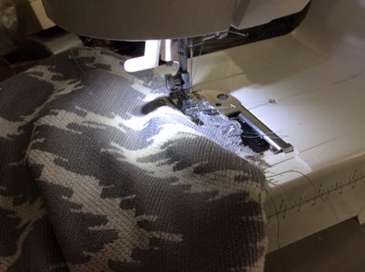

Step 9: Cover the Armrests

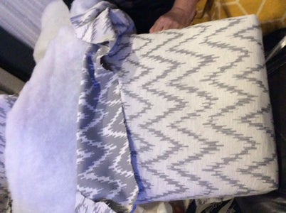

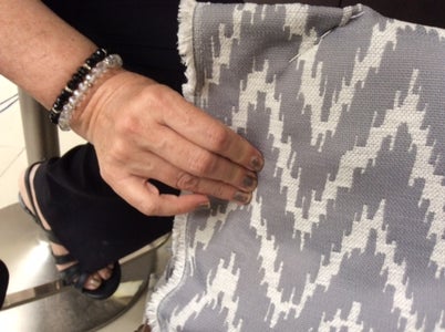

I put the fabric wrong side up, on top of the armrests and made a seam by hand at the curve and the front. Then I used my sewing machine to sew it.
Make sure you have enough extra fabric at the back because it will have to be stapled at the backrest. As shown in the last picture.

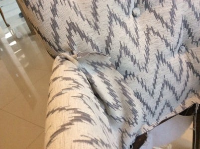

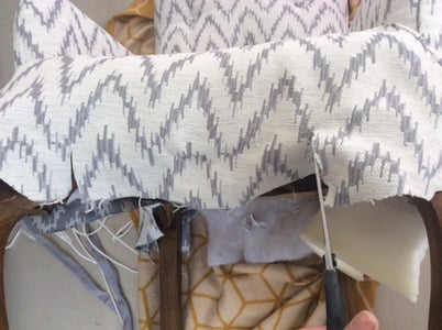

Step 10: Finish the Armrests

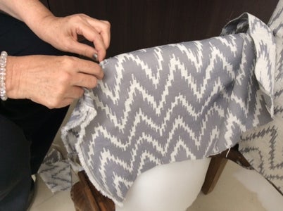

I cut the extra fabric at the front, cut some triangles to reduce the bulk, folded the edge and tuked in the corner.

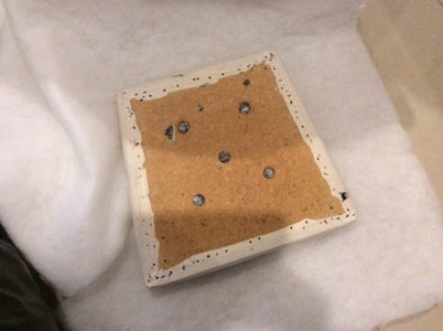

Step 11: Cover the Seat

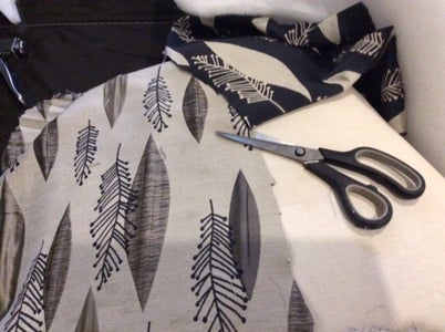

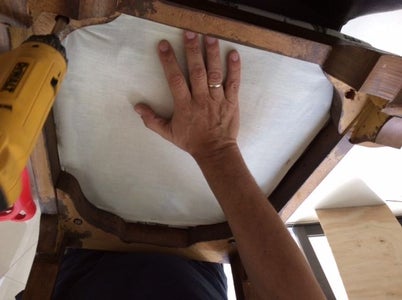

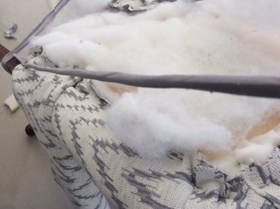

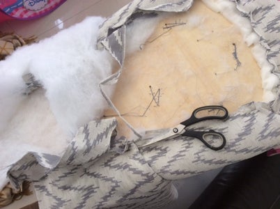

Before covering the seat with fabric, I cut the old fabric.
Then I covered the seat with a layer of wadding.
I had to make a seam at the front corners so that it will have a nice finish.

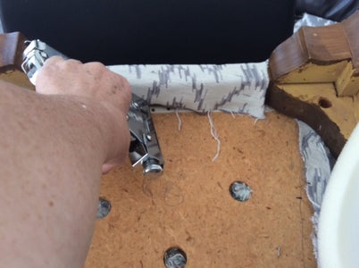

And stapled the new upholstery. I made sure I had extra fabric and wadding at the front side for next step.
Step 12: Assemble the Seat

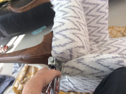

Then I assembled the chair.
I stapled the wadding and fabric from the front side at the bottom of the chair.
I had to make some cuts to fold the fabric at the top of the legs. Then continue stapling the fabric from the armrests at the bottom of the chair.

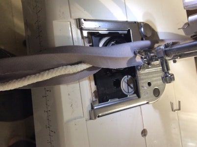

Step 13: Make and Staple the Piping
I used my sewing machine to make some piping. Although this step is not necessary, it will make the chair look more professional.
I started making it with the same fabric, but as it is thick it wasn´t looking good. So I decided to make it with bias tape. It looks perfect.

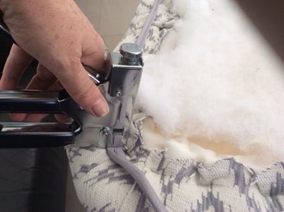

I stapled the piping all around the border. Except at the bottom.
To make sure the piping is tight and symmetrical, first put one staple at the bottom, then three staples at the corner, to make it round, some at the top, three more at the other corner, and one last at the bottom.

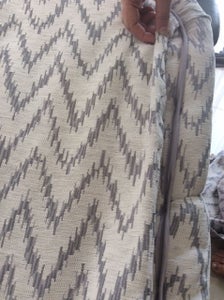

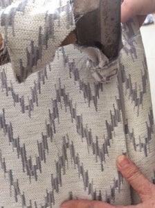

Step 14: Cover the Back of the Backrest
To cover the last part of the back, I stapled the top part. Then at each side I used a tack strip. I've never used this tool before, but it is easy and it looks great.
Just fold the fabric, put the tack strip in place and pierce the fabric thought the back side with the tacks. Then flip the strip so that the tacks face the wood and use a mallet to hit the tack strip. As I don´t have a mallet, I covered the tip or a hammer with scraps of fabric and used thread to make them stay in place. Here is a really good video showing how to use it.
When using the second tack strip, make sure you make the fabric nice and tight.
Finally I trimmed the excess of tack strip and piping, and stapled the fabric at the bottom of the chair.

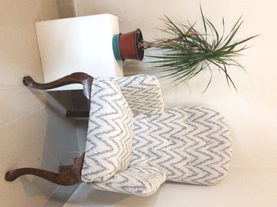

Step 15: Lessons Learned
Overall, I am really happy with how my chair looks now. For being my first upholstery project it's actually great.
I'm specially happy with how cheap it was to make, I used only simple tools that I already had, and the tack strip was really helpful.
So as a conclusion my two recomendations are: attention to detail is very important for a professional finish, and please don't forget to drill the holes for the buttons since the begining.
