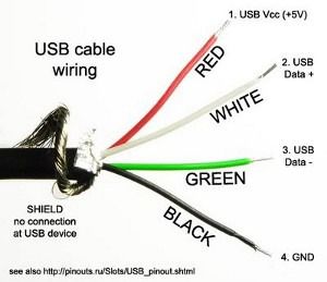

Step 5: USB Wirings/color Codes

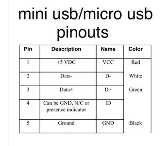

4."Carefully" scraped the usb male wire to expose its color coded wire,for identifications,which the postive & negative that carries the power needed ,it will pass through it to the battery.,Just get the Blue(for negative) & Red(for positive) the wire that picks the dc current ,and Discard or just cut the remaining wires color coded with White,Orange,Green,Black & the naked wire.You no longer needed those wire,those are for data connections dc supply to power micropone and webcamera.(Since the USB came from a pc camera.,those data wires and dc supply are for audio & video)Test it which one will work just look for Black/Blue for negative and Red/Orange for positive and the rest are for data.
•Note: Using a multi tester would be best for Continuity test.,for some usb male they only consist 4 wires.Just get the red or black if you found 4 wires in it.See image for some tips.

5.The confusing part,.Mostly on USB wirings.but its not,.soldering wires in color coded is a bit confusing.,as mentioned earlier in steps remember where is the positive & the negative wires.
