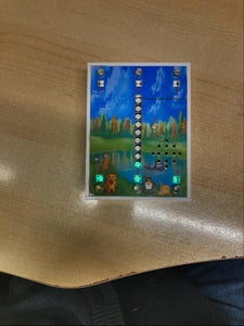

Step 1: Preparing the Front of the Housing
After tapping m3 threat in the holes, I screwed in 4 plastic spacers and I carefully removed any plastic that sticks out on the other side of the front.
Preparing the front Foil
I printed the attached pdf file with a color printer and I use a laminating machine to plasticize it. The laminating foil I used has a self adhesive side so it's easy to stick it to the front plate of the housing
Next, I cut out the print on the red line so it will fit on the housing.
I used a scalpel knife to cut out all the bigger holes. The small holes for the speaker, I cut out using a punch tool.

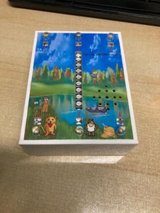

Step 3: Assembling the Housing
Glue all together, except the bottom plate.
Take note of how I mounted the battery. I placed some rubber dots around the battery and I pasted some foam tape on the bottom plate to keep the battery from moving around and shorting out the electronics.
In my version, I extended the switches will small cilinders that I cut from 10mm Acrylic. I simply but carefully glued them on the top of the switches. For the remaining windows I used acrylic bars, also cut with a laser cutter, glued into place.
