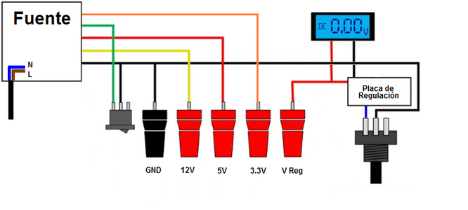

Identify the wires and eliminate what you don't need.
Step 2: Electronics2
Connect 230V ac input directly with electronic board. Then use the switch to control ON/OFF with green wire.

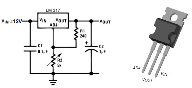

Build or buy the regulator circuit.

Mount all electronics like the schematics.
