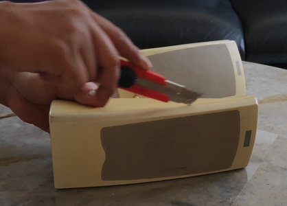

First Attempt : I'm using eucalyptus oil to remove the glue, and wait for a couple minutes (and it didn't work... LOL)
Second attempt : By using razor blade I scrape on each side of it and Voila....

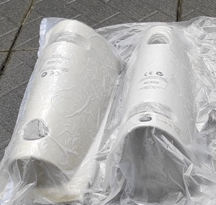

Step 3: Remove Yellowing Case (Retro Bright)
I Cleaned up all the case prior to Retro Bright action :D
Then I wipe with rag until it dry
For Retro Bright I'm using 50 % H202 (Hydrogen Peroxide), It's hazardous compound and precaution needed if you want to use them
I'm using paint brush to attach H202 with the case, and put it in clear plastic bag to reduce chemical oxidizing and maximizing UV light exposure.
Let's the magic begin
I put it directly in to the sun light approximately in 6 hours
and then voila... No yellowing anymore
Although it was not as look as a brand new, but it's OK
Then I flushed it with fresh water to neutralize the chemical

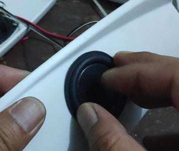

Making a hole with dremel for passive radiator and DC switch placement
Attach 3.5mm 12v DC socket for Battery charging port
Attach Power Switch
Cover all existing hole with glue gun, to get bass/passive radiator performance
Attach the passive radiator, and I'm using T-8000 glue which is commonly used for smartphone LCD

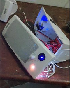

Install 12V 18650 Battery which I've already assembled within BMS Protection
Attached Led Battery indicator at Front Cover
Install Bluetooth module 5.0 ---->> XY-P15W
Install both 15w speaker on its case
Connect all the wire
And function test prior to final assembly
Attach front cover within the case
Patch all the side with glue and make sure no air hole exist
Step 5: Done
And it's done
