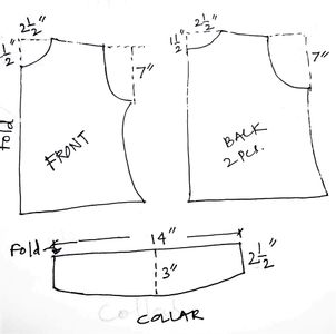

Mark leaving 5 inches from shoulder on both arm holes, join both markings with a curve. Refer the diagram. And cut it out.

Now take 1 piece for front. Fold it in half length wise and cut the shoulders and the neck. Refer the diagram.
Now take the other piece for back and fold in half length wise and cut it along the fold. Now cut the neck and shoulders as per the diagram.
Cut out 14 inches x 6 inches for the collar. refer diagram.
