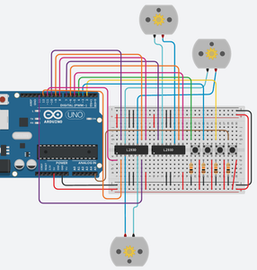

Step 4: Let's Put All Together
Since we have the code to activate the diffusers in the both desired way, now we can put all the components together to the breadboard, as in the screenshot from my Tinkercad Circuit Design.
