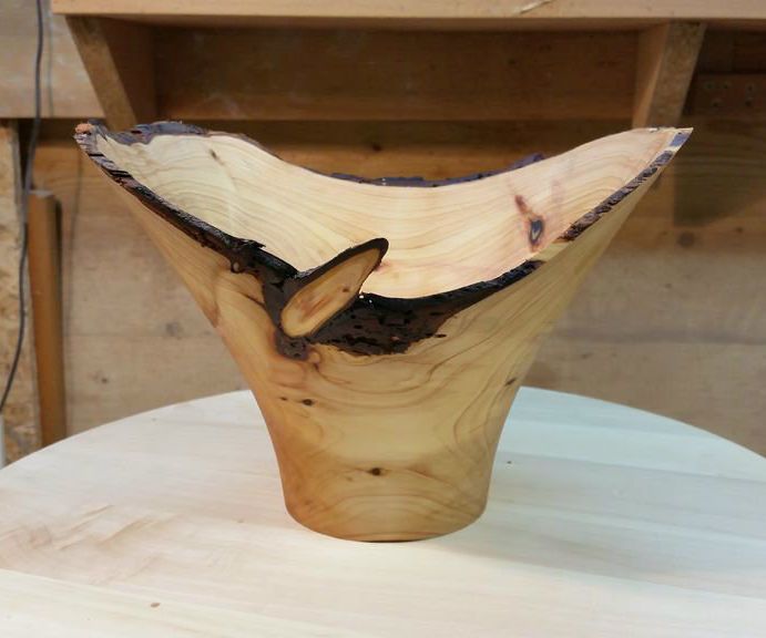

Introduction: Olive Emerging Lidded Vessel
Creating an emerging form is both a very creative and a very technical endeavour. But as you can see, it is well worth the time and effort. A piece like this combines so many different aspects of woodturning, such as a natural edge, a goblet, a lidded vessel, a finial (as part of the lid), and the curved wings, which, of course, won't make it easy to sand this piece down, but with some elbow grease, and some time on your hands, a piece like this is rendered 320 grit smooth.
