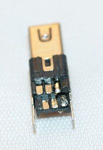

Step 4: Desolder Existing Connections
It is now time to remove the existing wire connections from the 12 pin connector.
Step 4
  • Use the soldering iron to desolder the existing wire connections
  • Use care to not over heat the connector and melt the plastic.
  • There are three connections that need to be removed. These connections are for outputting a video signal and are not useful for controlling the shutter release.

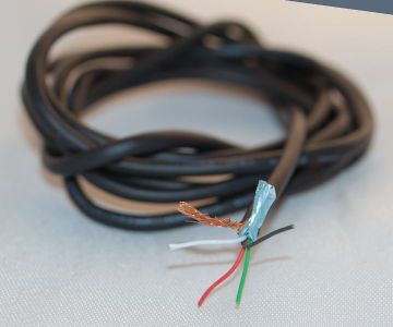

Step 5: Prepare the Cable Wires
Step 5
  • Strip the outer insulation from the salvaged cable
  • Gather the uninsulated wire together to form one bundle - this is the ground
  • Strip about 3mm of the insulation from two of the wires - about 1cm total of wire should be exposed from the outer insulation.
  • Trim any of the unused wires
Step 6: Solder the Wires
Step 6
  • Locate your patience and make sure it is in good working order
  • Choose two wires to use
  • Solder one wire to pad 11 and the other to pad 3
Some people have found that pin 4 is the proper pin. If you are having trouble with pin 3, try switching to pin 4. My cable is all sealed up and I can't check any more. If you have successfully completed this Instructable, please let us know which pin worked for you.
  • Solder the ground to the outside housing
  • Use care and a fine pointed soldering tip to ensure that each wire is soldered to only one contact.
Pads 1-6 are located on the TOP side of the connector
Pads 7-12 are located on the other side.
See the pictures below for help locating the proper pads. If in doubt use a multi meter to match each pin to its pad.
The following pin-outs may be useful
1 - USB DATA +
2 - USB DATA -
3 - Shutter Release (when combined with 11)
4 - Audio - Center (?)
5 - Video Center
6 -
7 - Video Shield
8 -
9 - Audio Shield
10 - USB -ve
11 - Auto Focus, Meter (half press of shutter release button)
12 - USB +5ve
Shell - Ground, USB ground
Thanks to Richard from the dpreview.com olympus forum.
