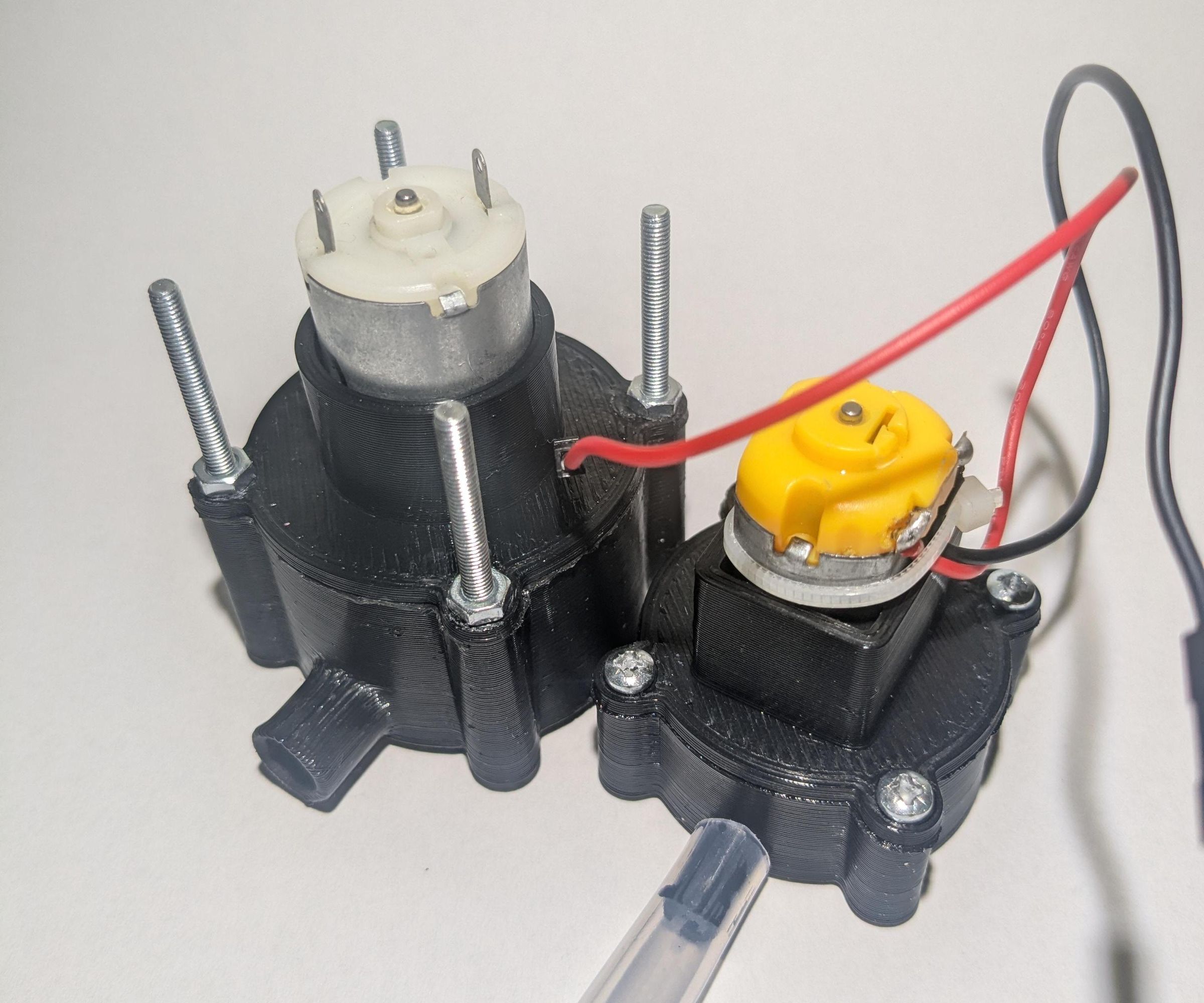

Step 3: Assemble the Parts
Assemble the Rotating Rart:
When assembling the spinning part I recommend trying to balance it. That will reduce the amount of vibrations.
Mount the Motor:
Secure the 5V motor onto your 3D‑printed motor mount. Ensure it is fixed and aligned so that its shaft will drive the rotating hub smoothly.
Attach the Rotating Hub:
Mount the rotating hub onto the motor shaft. This hub will serve as the base for the display.
Attach the Slit Cylinder
