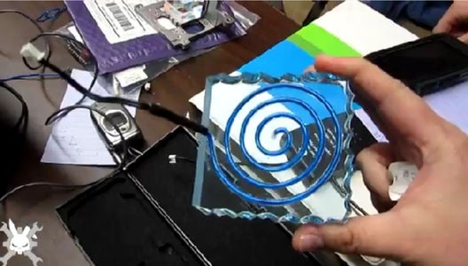

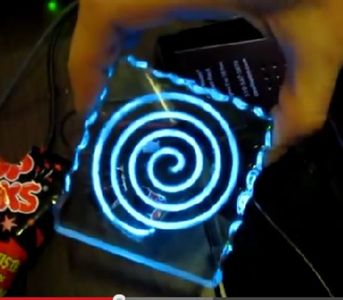

Images on this page show another project we tried out...we had access to a laser engraver, cut a gouge deep enough to insert the EL wire, and lit it up with the supplied battery pack...makes for a nice glowing desktoy/paperweight!
Soldering is possible
Don't worry though, with EL wire it is possible to solder together segments together, so should you cut a segment too short you can add length back to it.

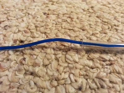

Step 2: You Can't Push a Rope
Can't push a rope
You know the old saying, you can't push a rope, well we gave it a good try. It turned out the EL wire
we got wasn't certified as waterproof (there are versions of EL wire available which are waterproof)
We wanted to experiment with some applications that would require the wire to be somewhat waterproof, so to address the issue, I wandered down to the local hardware store and picked up clear vinyl flexible tubing (the kind used for aquarium air supplies)
I selected tubing that would allow the wire to feed into it.
At less than $.40 a foot, I asked for some excess to be trimmed later.

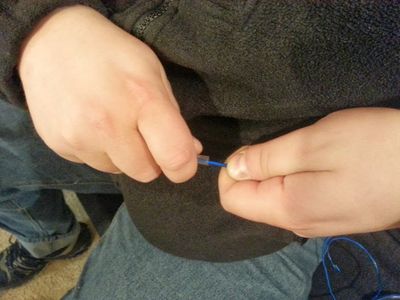

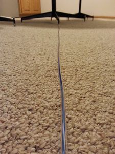

Next I straightened the tubing and wire as much as possible.
I anchored the far end under a table, to help hold it straight.
Next I fed the wire into the tube. It slid through for about 8 inches before becoming stuck.
I twisted the tube to help the wire along. and started feeding the wire in smaller segments.
This helped keep the wire from kinking too much. It seemed to become stuck periodically, this became frustrating.
Twisting along the length of the tube seemed to help straighten it out and move the EL wire down the tube.
Eventually, about 1 ft from the end I found a spot where the internal cavity of the tube changed, there must have been a crimp or a deformity in manufacture.
I tried a variety of stretching and twisting on the hose. However, the EL wire would not pass.
I decided against lubrication as I didn't know how it would effect the finished look.
I was able to get a smaller wire all the way through. But was unsuccessful at pulling the wire past the same point.
Since we had enough length we decided to simply cut that section of the tube off
Finally sealed it the end of the tube up with a dab of glue
This should make the wire more water resistant.

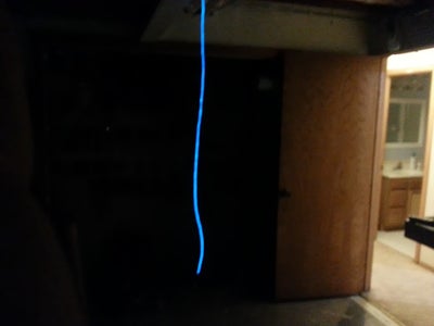

Step 3: Set It Up.
Experimental EL Wire Application #1. Omni-directional indicator
By suspending the EL wire over a space, EL wire can identify a space below it.
Advantages, the EL Wire glow can be seen from any direction, it's waterproof and if bumped it will simply flex out of the way.
