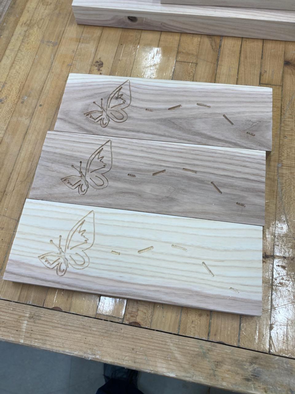

Step 9: A Little CNC Detail
The CNC router is really fun, and it seems to find a place in every project that I make. I use Easel software on a Millright CNC router and am very pleased with the setup. I'm not going into a ton of detail here because that opens up a whole new can of worms and the CNC process could be an instuctable all on its own!
For those who are interested, I am cutting with a 1/8" diameter 60 degree V bit and 2mm depth of cut. Feed rate and plunge rate are 4000mm/min.

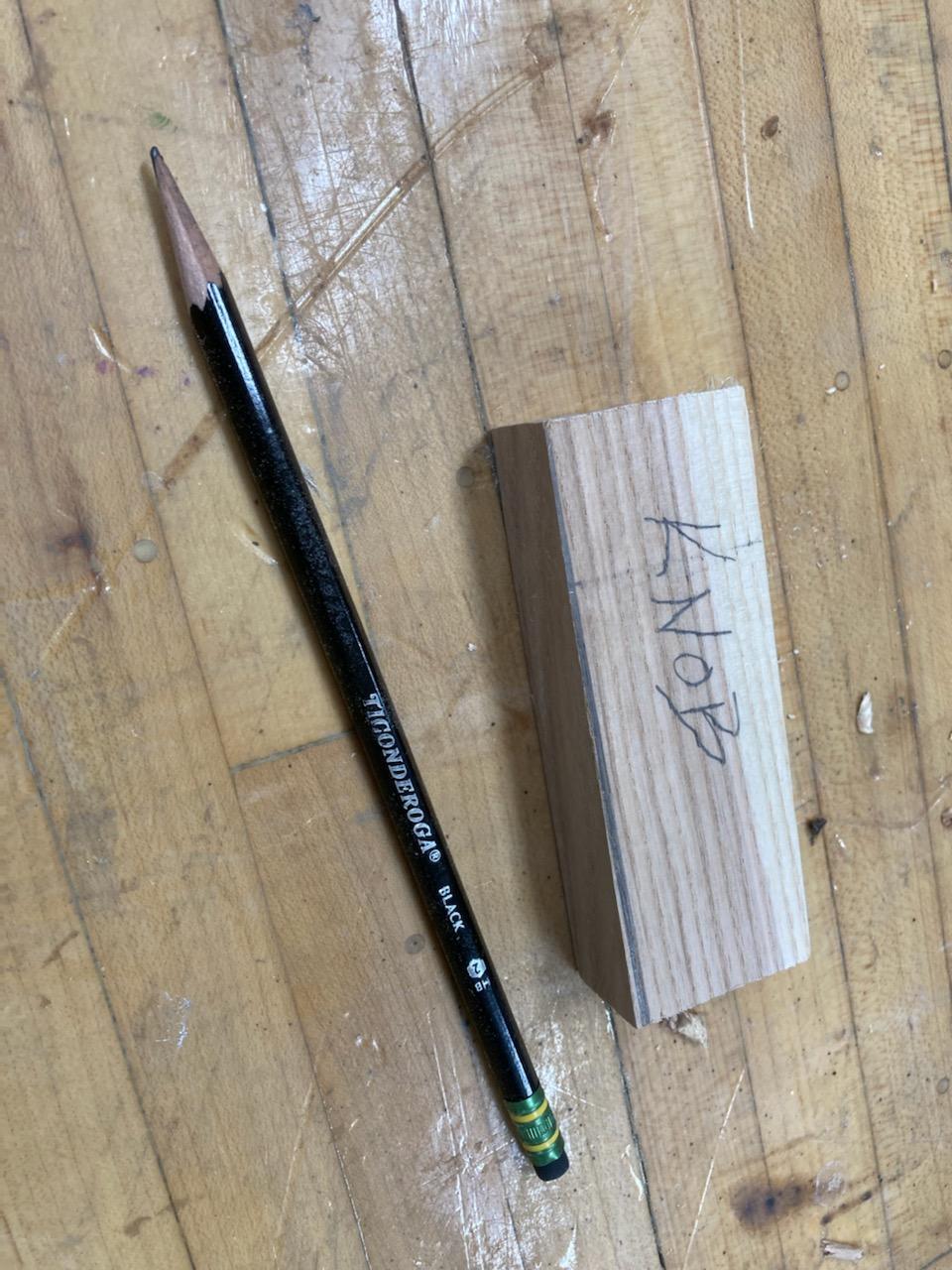

Step 18: Make and Attach the Drawer Pull
I had budgeted a piece of ash about 1 1/2" x 3" for the knob, and ended using about 1/4 of it. I cut a simple tapered rectangular knob for the drawer. I feel like this matches the overall style of the table. One screw and a couple drops of wood glue hold the knob to the drawer front.
