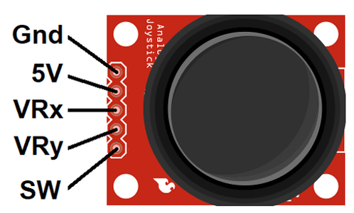

To connect the analog stick to the pico you need to:
- Join the ground wire on pin 38 to the ground on the analog stick (power)
- Join the 5v to the 3v3(out) on pin 36 (power)
- VRx to pin 32 (movement on the x-axis)
- VRy to pin 31 (movement on the y-axis)
- SW to pin 34 (button press)
