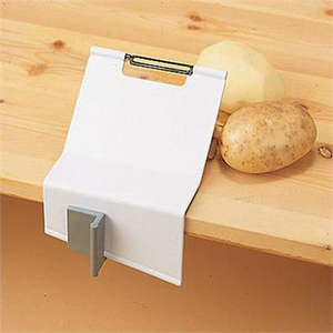

We found similar designs and products on the market, such as the one-handed vegetable peeler or the food grater and scraper. Neither were quite what Aaron wanted, but he liked the one-handed vegetable peer idea and suggested a few modifications.

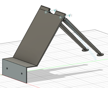

The design we settled on was based on the one-handed vegetable peeler but adding a stabilizing stand on the back that would grip the countertop.

For the first prototype, we attempted to 3D print the arms and main body as one and the clamping board and small piece that would be parallel with the tabletop were printed separately. After a couple of unexpected printer errors that would cause us to reprint twice, a prototype was made.
This prototype was rough but an amazing learning experience. Here are some of the discoveries we made:
- the surface was covered with the support layers for the print, making it a lot of work to clean up and smooth out
- the holes for attaching the pieces were extremely weak and brittle because of the orientation we printed them
- the final problem was that the cutout to fit the blade was too small and did not allow us to fit the peeler blade into the design.
From here, we got some advice from mentors and brainstormed methods for making a better design. The changes made for the final prototype were:
- editing the dimensions to better fit the blade
- added a chamfer to all the corners
- removed the print in leg joint and changed it to a similar joint to the clamp piece and middle piece by using a wooden dowel. This will make it easy to disassemble and store and clean each component as necessary
- increased the thickness of the dowel joints so that they will have more durability
