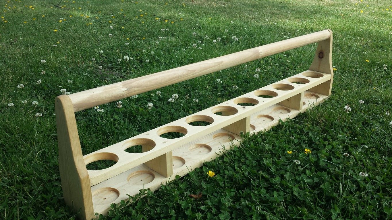

In most Belgian pubs you can order a (metric) meter of beer which are 10 or 12 draft (Pilsner) beers served in a wooden holder. I thought it would be cool to have my own "beer meter" and use it at BBQs and take it to festivals. I made my beer meter from reclaimed pallet boards and an old wooden curtain rod that I was saving to use in a project. It only cost me a bit of wood glue, peanut oil and the electricity consumed by my power tools.

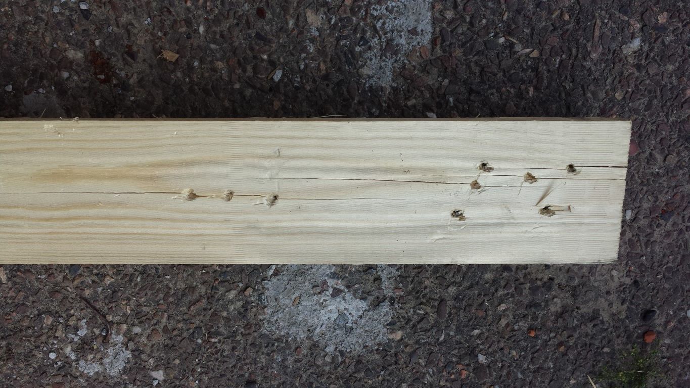

When you disassemble a pallet it happens that the ends get cracks especially when you use brute force like I do. You can cut of the cracked part and use it to make a fire or you can reclaim your reclaimed board to make dowels. We will use the dowels in step 4, so hang on!

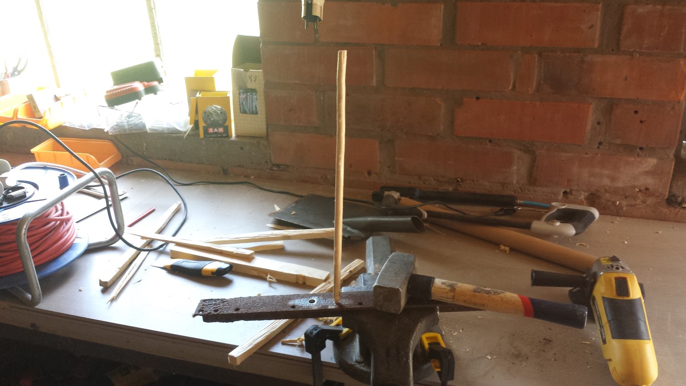

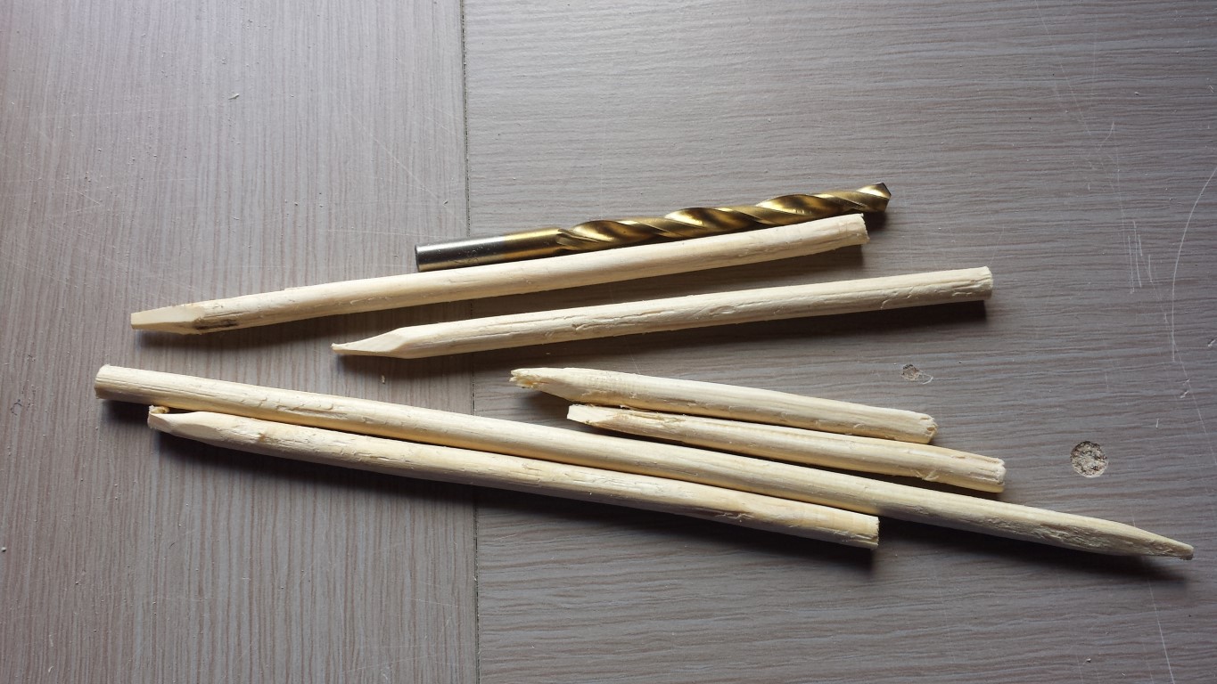

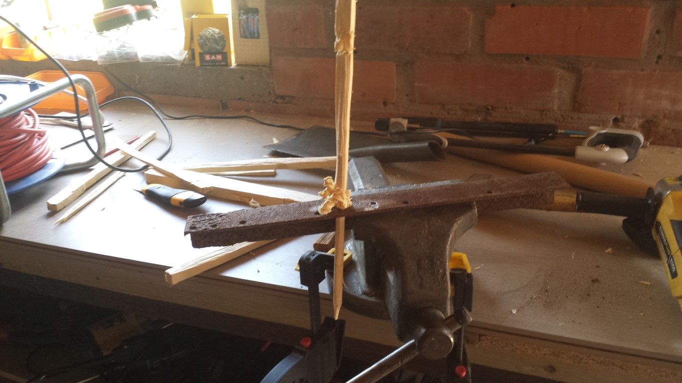

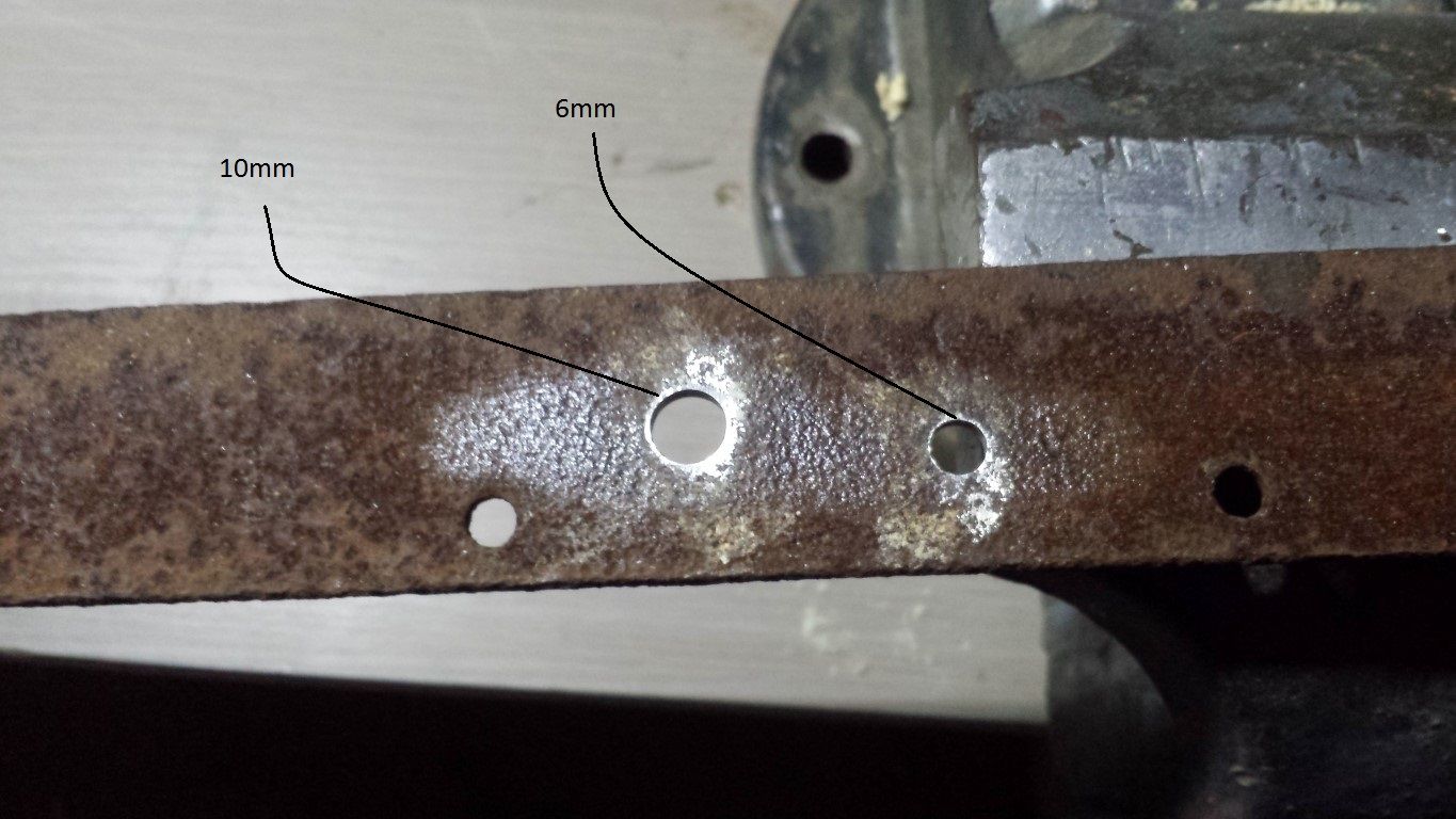

There are many techniques to make dowels but the easiest is to hammer a piece of wood through a hole. I drilled two holes in a L-shaped iron scrap and clamped it in my bench vise.
I first used a crafts knife to pre shape the wood and made a sharp point to one end. This will make it easier to hammer it through the first big (10mm) hole.
Then I smashed the 10mm dowel (yes it's a dowel already :-) through the smaller hole to get a 6mm dowel. I also kept two 10mm dowels (15 cm long) to attach the handle to our beer holder.
Next I sanded the dowels to make them smoother. They ended up not that straight but I was happy with them and figured it was time to proceed with the next step.

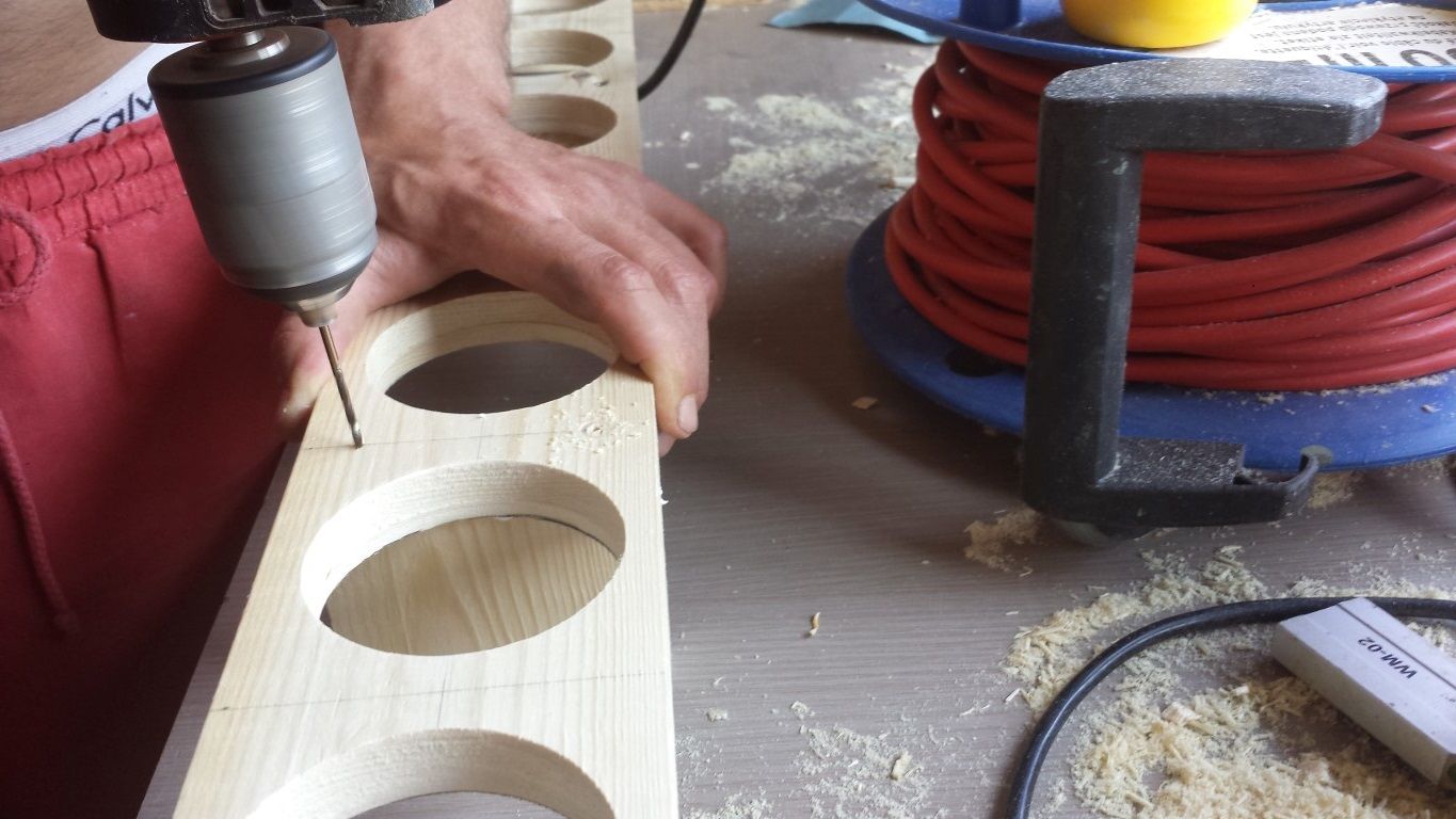

I selected two pallet boards that didn't have any cracks and cut them to length with a miter saw (100cm each). I drew a centre line and divided each board in 10 "squares". Next I marked the centre of each square. I used an other board to make 3 middle pieces (7cm long) and 2 side panels (30 cm long). The middle pieces will attach the top and bottom boards and the side boards will hold the handle (1 meter wooden curtain rod).
Top board

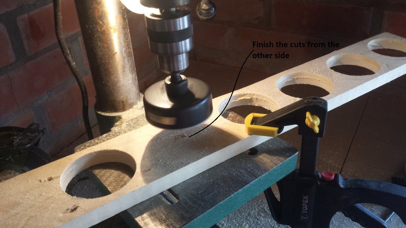

I used a 7cm (diameter) hole saw on my drill press to cut out circles. I did not went through the board immediately but preferred to turn it around and saw the second half from the other side. This will give a cleaner cut and it will be easier to remove the wood from your hole saw since it will stick out.

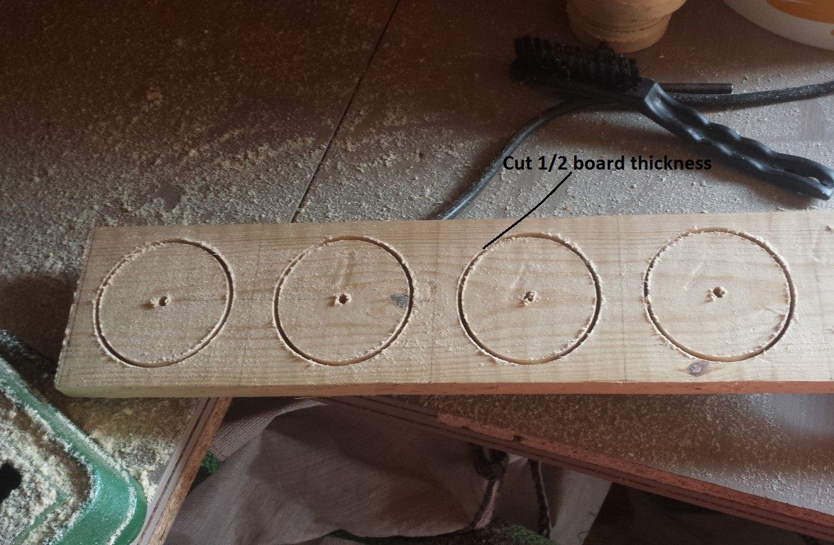

Bottom board
For the bottom board I used a smaller hole saw (5.5cm) and only went 8mm deep. The cuts are made to make it easier to free hand "perfect" circles with a hand held router (set your bit also 8mm deep).
Side boards

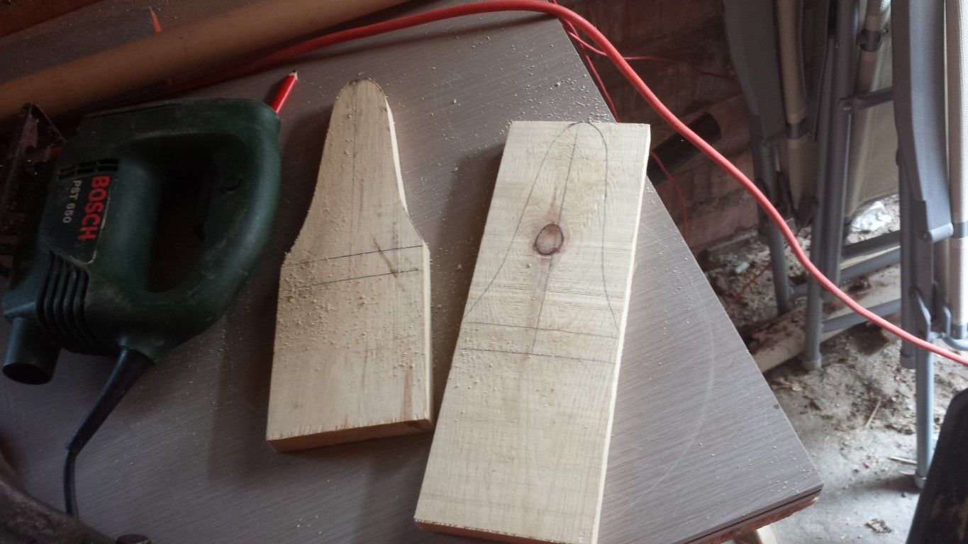

I made a (half) template from a cardboard piece and traced it's shape on the 30 cm long side boards. I used a jig saw machine to cut out the shapes.

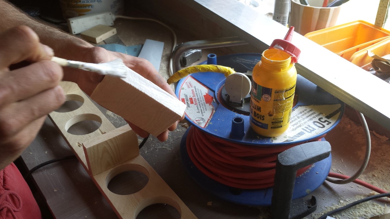

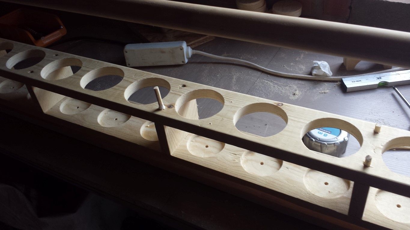

I first applied a good amount of glue to the joints and aligned them (on sight) on the top board.

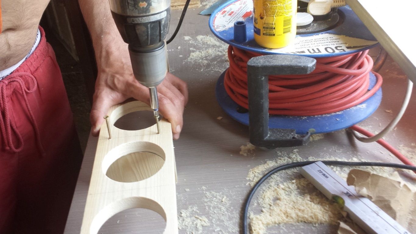

I used the dividing lines as a guide to drill pilot holes 15mm from both edges.
I added temporary wood screws to clamp the pieces together. (don't you dare to look at my belly button!)
Note: do the same for the bottom and side boards. Every joint must be glued and clamped with two wood screws.

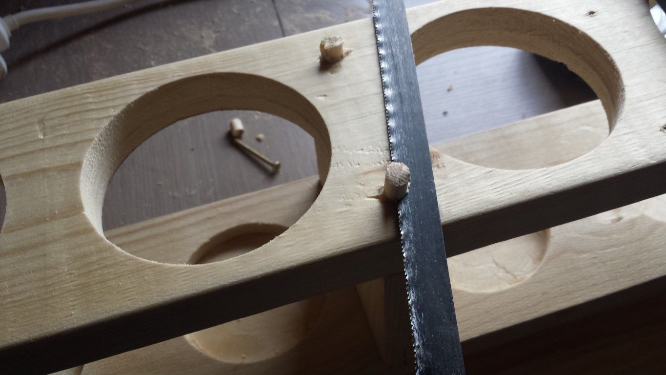

Step 4: Replace Screws With Dowels

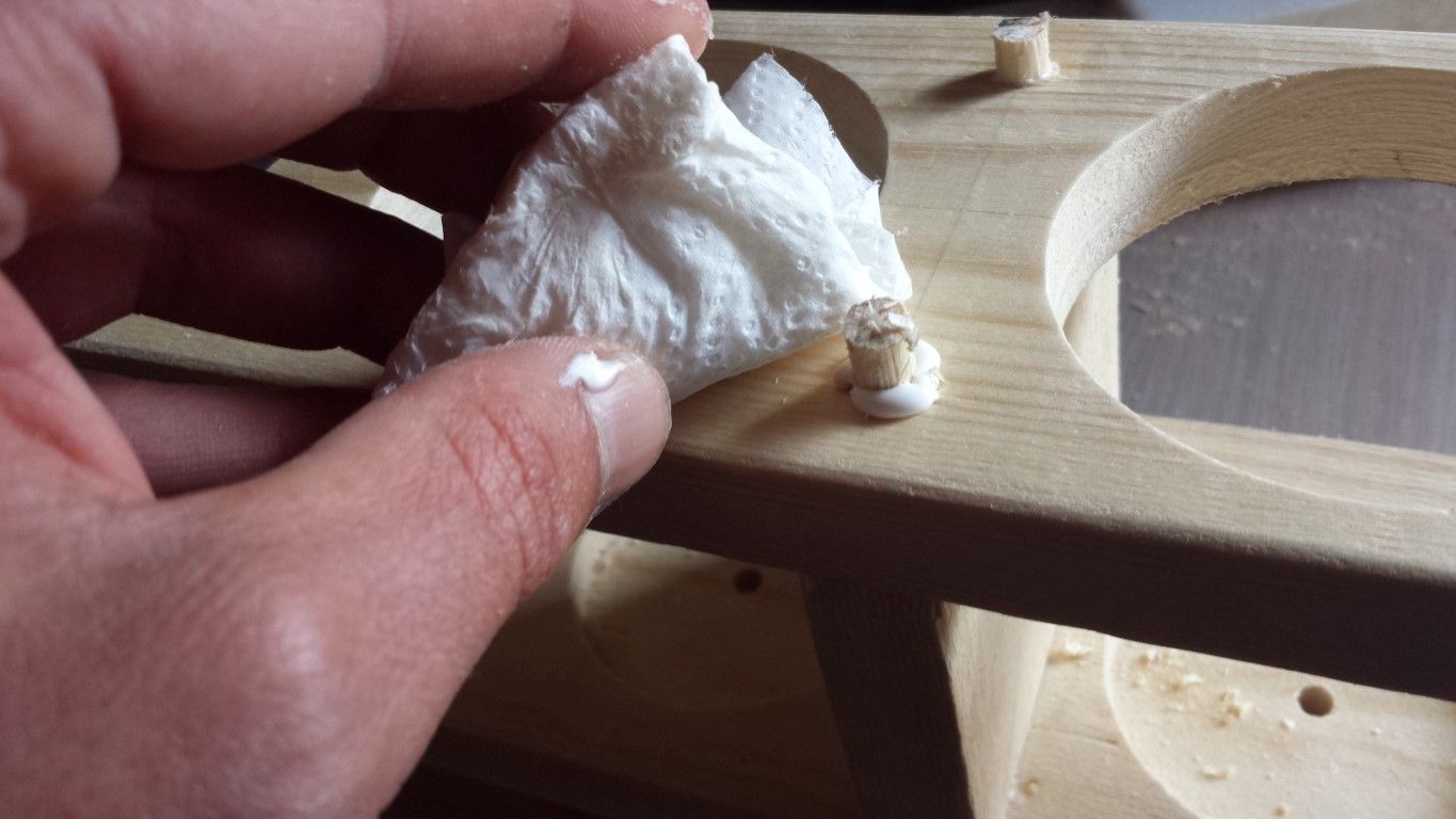

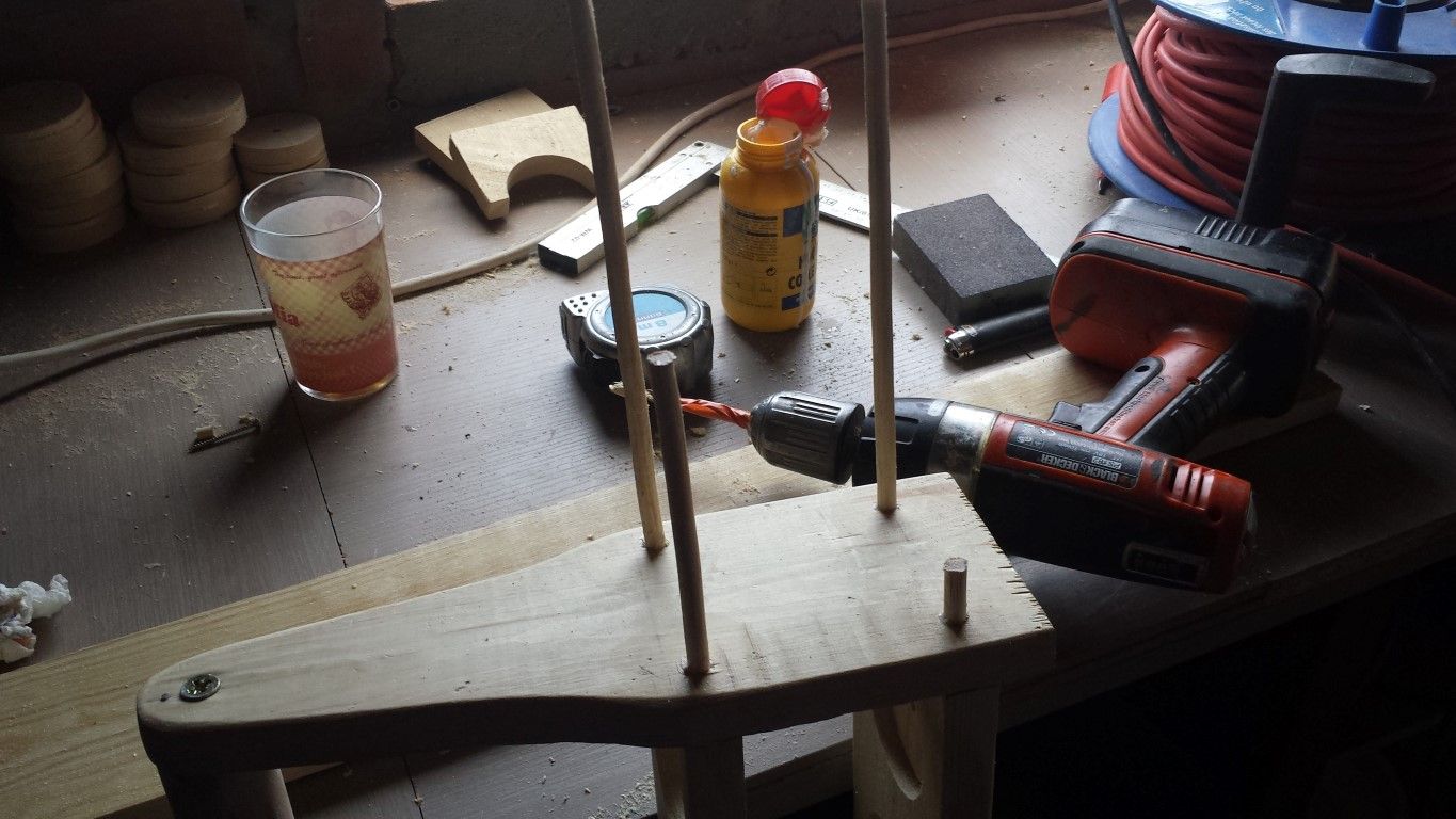

Once the glue was set I removed all the screws and drilled 6mm pilot holes for the dowels (joint after joint).
Add enough wood glue and wipe of the excess after hammering the dowel in the pilot hole.

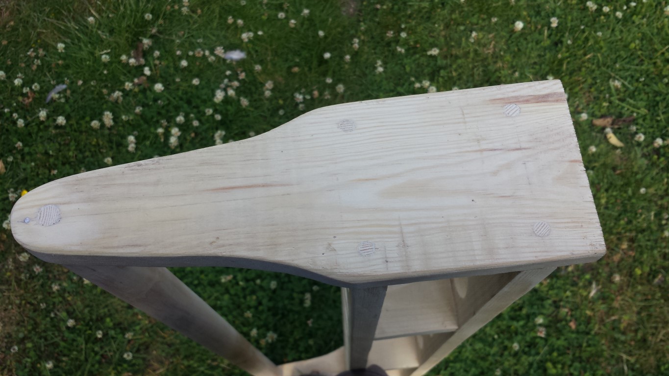

I used an iron saw to cut of the dowels and then sanded them flush with the board.
The handle is secured with a long 10mm (diameter) dowel at both sides. I also smashed in a small nail to reduce the rotational stress on the glue.

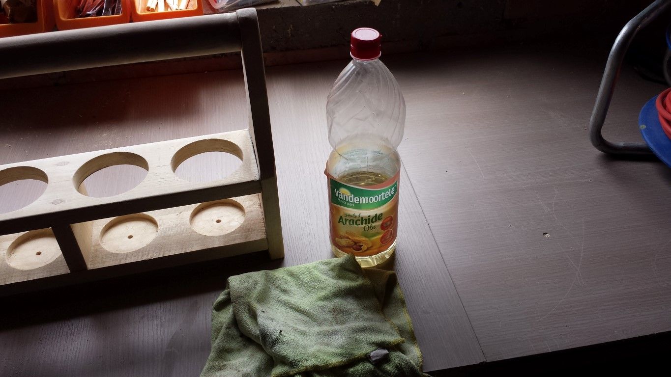

After the sanding I applied a coat of peanut oil (stolen from the kitchen) with a piece of cloth.
The oil will protect the wood from spoiled beer (or other drinks) without using poisonous chemicals. Also it makes the wood/grains more vivid. Of course you can finish the wood to your own liking but I wanted to keep it as natural and cheap as possible.

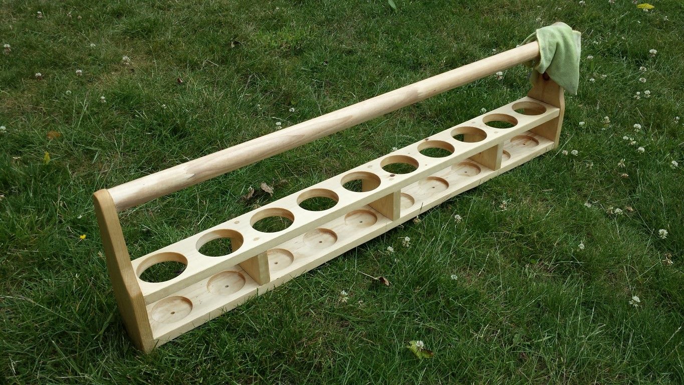

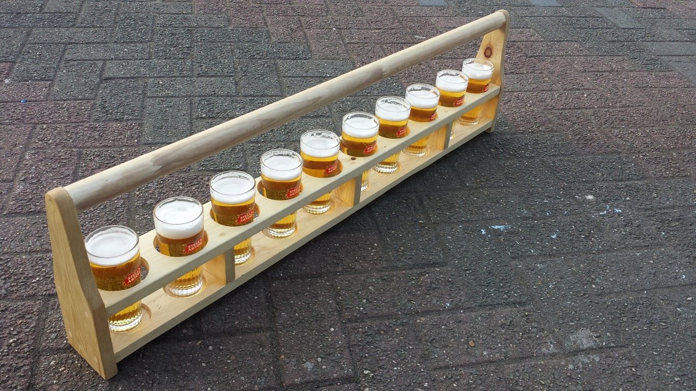

Final note: it took about 3 hours to complete this project. I did not have any plans when I started the project. In fact I started making dowels without knowing for what I would use them. I will probably make a second "beer meter" because I think I will give this one as a present to my father in law. I will not use "full" pencil lines again because they were not easy to remove. Also I will make the handle a few centimetres higher above the top board so there is more space to fit bigger glasses and bottles.
Update: this update is to tell you what happened with my beer holder. The day I posted this instructable I went to my favourite pub ("Het Stationeke in Olen"). After a few "Duvel" beers I made a deal with the bartender. I told him that I needed a full meter of beer to update the cover image of this instructable. He immediately tapped 10 free beers and I gave him the beer holder in return. So if you happen to be in Belgium (Olen) you may want to visit "Het Stationeke" and order a meter of beer! The pub is located on the railway platform in Olen. They even have their own railway inside the pub and have a small beer museum!
