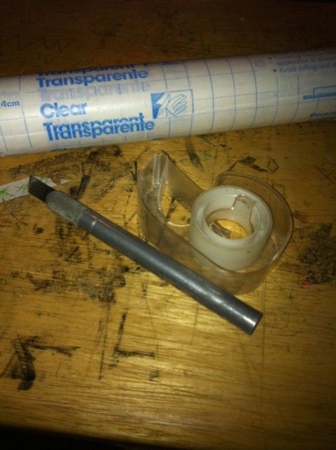

You're going to need...
1. A blank screen. You can either make your own out of an old picture frame and some fabric from a fabric store, or just buy a blank one at an art store. I'd tell you how to make one, but this is about the printing itself.
2. A picture of something you'd like on a shirt. The easier to trace and cut out, the less hassle you've got to go through when you place it on the shirt, or, you could just draw it directly onto the contact paper.
3. An x-acto knife, or any other hobby type of knife.
4. A sharpie marker, to trace your picture or to draw on the contact paper.
5. A roll of contact paper. This is what you'll be tracing or drawing said picture on to.
6. A screen printing ink of your choice. Also, if you'd like, you can use those weird tulip slick paints. Not the glitter kind, those will screw your screen up.
7. An ink squeegee.

1. Trace or draw your item onto the contact paper. Slick side up, please.
For those of you under 50, contact paper was used many moons ago to line the insides of drawers or something. Cavemen also used the heavy rolls to club unsuspecting women to drag back to their caves.
You can purchase a roll of it in the kitchen type of isle at Walmart for like, 4 bucks. You get A LOT of this stuff. I use clear, because I trace stuff. They've got white if you're more of an artist and you don't want stuff showing through.
Anyway.
2. After your design is traced or drawn, cut it out using the x-acto knife. The more simple the design, the easier time you're going to have. Sure it's possible to use islands and stuff, but it's all about how comfortable you are. It gets easier in time, I promise.
