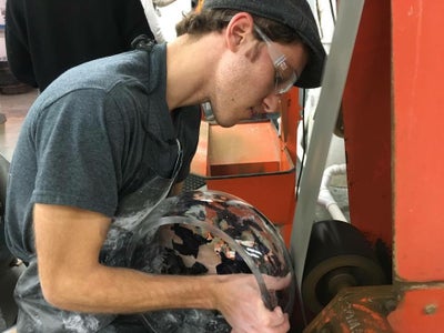

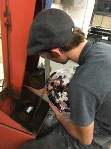

Once I had the shape of the edges roughly there, I had to shape the facets on the “echo” bowl and bring both vessels, as it’s called, to a full polish. What that means is repeating the same process over and over again, each time moving from a rougher grit to a finer one. Rougher grits grind away more material quickly, but they leave a rough, opaque surface. Finer grits smooth out the imperfections, but take much longer to do so since they’re removing much smaller amounts of material. Eventually, the grit gets small enough that the surface becomes transparent, setting the stage for a true optical polish. This process was especially difficult with the faceted “battuto” surface I wanted on the “echo” bowl, since each round of grit had the potential to change the geometry of the facets, either throwing the facets’ proportions off or destroying their flatness.
When glass is wet, it looks shinier, so it becomes nearly impossible to tell which areas of your object have been hit with the current level of grit. It’s important to go in even passes, covering the full surface each pass through, because if you skip a level of grit on one part but not another, that inconsistency will show up later as scratches or pitting in the polished surface. The way to tell what you’ve already ground is a highly sophisticated technique – cover the whole thing in black sharpie. When the ink’s gone, you know you’ve touched every surface with that level of grit. After the initial shaping, I used a series of increasingly finer “diamond wheels,” (thin, flat metal discs like a big vinyl record studded with diamonds) to hone and tweak the geometry of each facet while bringing the whole outer surface closer to a polish.
After many (so many) hours, the facets were done and all that remained was to smooth the transitions and polish the whole thing. I used a fine belt sander – a giant strip of rotating wet sandpaper – to smooth the transitions, and a polishing compound of water and cerium on a spinning felt wheel to make the whole surface optically transparent.
