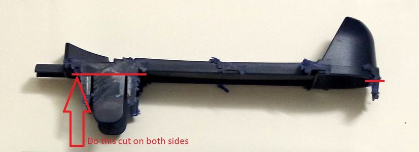

Step 2: Packaging Cutting
The very first step is to cut away the interesting part from the original packaging.
Take a close look at the packaging and plan your cuts ahead (photo 1).
With the use of your hacksaw blade, cut the part where needed (photo 2).
You should end up with the interesting part now separated from the original packaging (photos 3 & 4).
