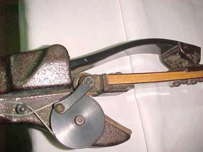

Step 4: Take It Apart! the Timing System:
A „normal“ compound bow is a bit of a tedious thing, because the complete setup is always under tension. In case the string should break, you have instant catastrophe. If you want to replace the string on a regular compound bow, you need to put strain on the limbs with a bow press.
An Oneida lever bow is a different kind of animal. It was designed to be robust and serviceable under field conditions. The new bows are a bit more finnikey, but with the old ones, you can simply release the tension on the limbs to take everything apart.
The timing system is the most complex and tedious part of the bow, so make sure to look at it in detail before taking it apart. It is a simple mechanism, but getting it back together as it was may prove more difficult than you‘d expect.
The synchronization of the cam system is achieved using a so called Timing Cable, which forms a loop that runs around each Timing Wheel and via a set of Idler Wheels on each end of the riser and through a groove along the middle of the latter, that is normally partially covered by the (then glued on plastic) handle. Notice that the cables don‘t run parallel through the groove, but are crossed there to achieve the synched movement of the wheels - i.e. both turn either toward the inside or outside of the bow at the same time.
Since the cable is thinner than the power cables, you don‘t want to put much tension on it. Also, the large plastic timing wheels are not meant to take much strain, so it’s another good reason that you want to check the timing cable while you are releasing (or adding) tension. But, Oneida once stated that for the older bows it was not necessary to release the tension of the timing cable when adjusting the poundage of the bows. I tried it and had no problems - best to release the tension anyway.
So, simply unscrew the large tension bolts until you can remove the string, or do it the right way….
A - Tension Adjustment:
Thus, the first step, after documenting everything, is to loosen the small socket head screw (5/16“), situated in the rim of the upper limb timing cam, to release the timing tensioning hub where the cable is wound for tension adjustments.
Though the cable forms a loop, it consists of two equal lengths that are held together by clips at the ends. These are each held in place by a hole in the rim of the timing wheel of the lower limb and by the bore in the tensioning hub on the timing wheel of the upper limb. After releasing the tension, the cable can be plied from both and then fiddled out of the system. You can also wait until further disassembly.
B - Idler Wheels:
Toward each end of the riser is a steel shaft on which sit two plastic Idler Wheels that have no further attachment, because the cables hold them on the pins anyway.
In my case both rods were well corroded, so that it was difficult to remove the wheels. After removal, the pins were cleaned with steel wool and de-rusted as described in Step 7. During reassembly they were oiled and greased like the other relevant parts.
Document, or remember the way the cables run across them and are crossed through the groove of the riser, so you‘ll have an easier time during reassembly.

Step 12: The Mohawk Laser
The father of the Oneida - one absolutely cool bow - an awesome construction.
I want one!
Maybe I will build one myself, reverse engineered from the photos….
If you build one, please give me one too!
