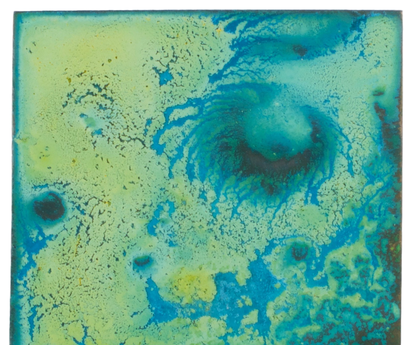

Step 4: Make It.
- Slice or chop the yellow onion.
- Make an onion, copper, onion sandwich (Tip: more onion is not always better).
- Wrap the cloth around the sandwich evenly.
- Tie securely with a bit of yarn or string.
- Drizzle 1 teaspoon of ammonia evenly, a bit on both sides of the cloth.
- Pop into a zip bag and let cook (sit) for 4 days.
- Remove from zip bag and soak in warm water for about 15 minutes.
- Open up the cloth. The onion may or may not be “stuck” to the copper. If it is stuck, let it dry completely (could be a few days), until it will flake off.
- Wash gently in warm water and allow to dry.
- If the onion is not stuck, simply wash gently in warm water and allow to dry.
