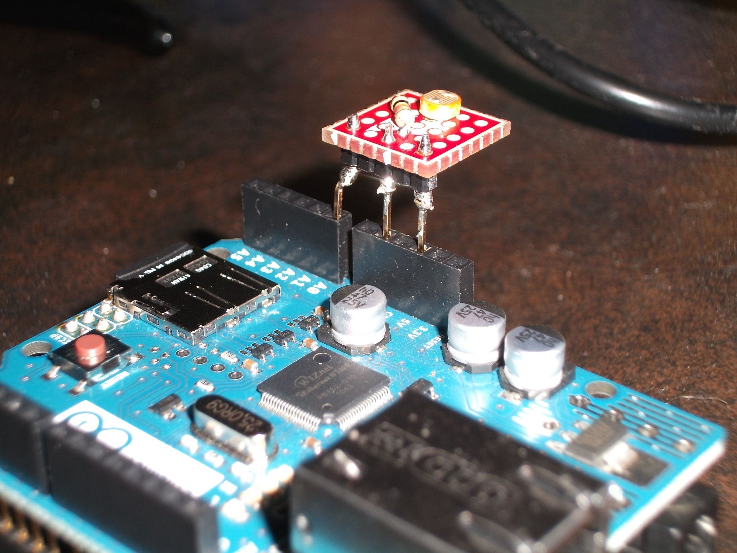

Step 1: Sensor Assembly
The light sensor is just a cheap photoresistor that I rigged up on a small perf board to plug directly into the 5v, gnd, and A0 pins of my Arduino (or more precisely, the headers on the Ethernet shield). It is set up in such a way that the minimum recordable light intensity is zero, while the maximum is 1024.
The pins on the male headers don’t quite line up, so I intentionally used extra long ones and added a slight S-curve to the one that goes to A0. This can be seen in better detail above. For those who are interested, the circuit is very simple, and a schematic can be seen in the last image, or the actual layout can be seen in the second last.
