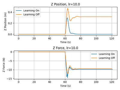

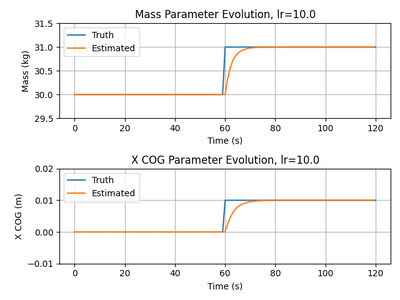

Step 3: Simulation
We took advantage of the batched implementation of our model to run quick simulations of the performance of our system. We used the torchode library to compute the trajectories of a simulated vehicle.
Our simulation setup included a vehicle with an inverse dynamics model with parameters that perfectly match the simulation model. After some time, the simulation model parameters undergo a step change, rendering the inverse dynamics parameters incorrect. Without our model identification system updating the inverse dynamics parameters, the vehicle fails to regain its original pose. With the system running, the inverse dynamics parameters quickly update to match the simulation parameters, and the vehicle successfully maintains its pose.
