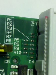

Finally you will need to enable the SPI hardware on your Raspberry Pi. To do that you must edit the file /etc/modprobe.d/raspi-blacklsit.conf. You can use your favorite editor to do that, but in this Instructable I will assume nano. The following command will bring up the file in the editor:
sudo nano /etc/modprobe.d/raspi-blacklsit.conf
Once inside the editor you must ensure the following line is commented out:
Save the file and reboot. Once your Rasbperry Pi has rebooted you can check if the SPI interface was enabled successfully by running the following command:

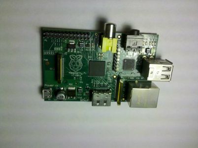

- A Raspberry Pi (I used a Model B for the project, but a Model A is shown in the picture - there shouldn't be a difference)

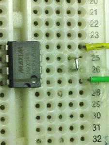

Step 3: Hardware: Part 2 ADC

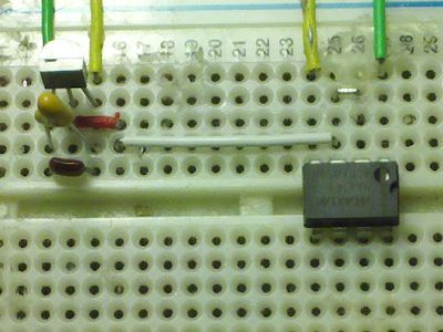

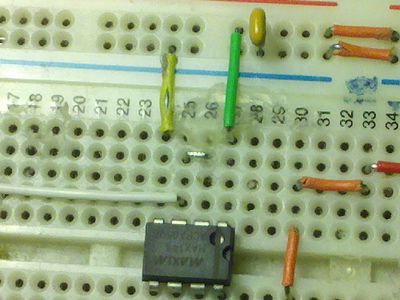

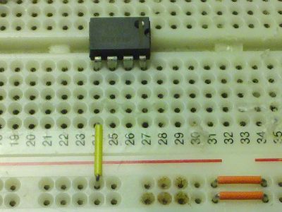

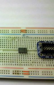

- Place the Max 144 on the breadboard. Leave room for the cobbler. A little off center is the best place. Note the orientation!

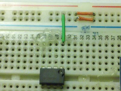

- Connect the Ref/Vdd and Gnd wires on the Max144.
- Short CH1 and CH2.
- Place .1uf Capacitor (as close to the Vdd lead as you can get it).

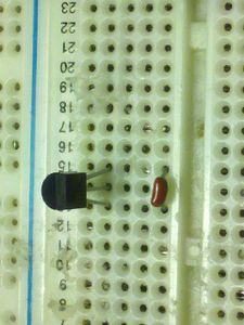

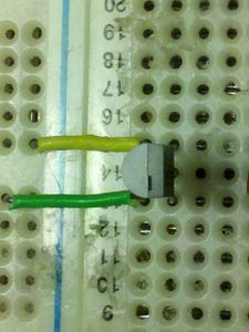

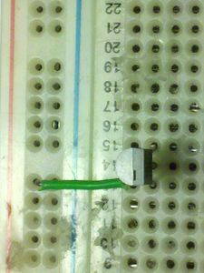

- Insert the TMP-36 into the breadboard. Note the orientation!
- Connect Vcc to 3.3v (Again, note the orientation)
- Connect GND
- Add a .1uF capacitor between the 1st and 3rd leads.
- (Optional) 2.2uf Tantalum capacitor. Watch the poarity - positive lead should connect to Vss. Only use if you have noise problems.

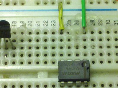

- Connect middle lead (pin 2) of the TMP-36 to CH2 (pin 3) of the MAX-144.

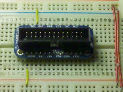

- Connect 26 pin ribbon cable to Raspberry Pi. Notice orientation of cable in relation to P1 on the Raspberry Pi motherboard. Make sure you match it exactly.
- Connect SCLK to the MAX-144 SCLK (pin 8).
- Connect MISO to the Dout pin of the MAX-144 (pin 7).
- Connect CE0 to the /CS pin of the MAX-144 (pin 6).
- Connect 3.3v pin from Rasbperry Pi to 3.3v rail of breadboard.
- Connect GND of the Raspberry Pi to the ground rail of the breadboard.
- Connect 26 pin to Raspberry Pi Cobbler.
