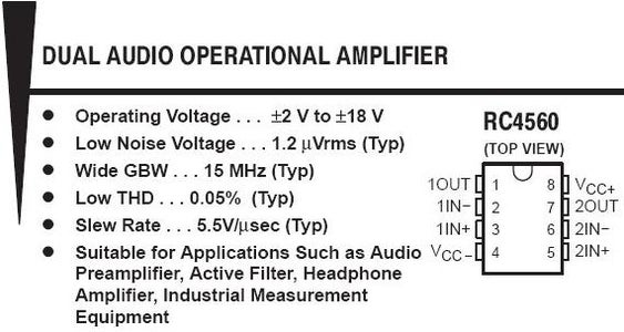

Step 1: The Op Amp
The active device is the RC4560, which Texas Instruments claim to be suitable for, among others, Headphone amplifiers. It can work down to +/- 2 volts, and has low noise and a wide enough bandwidth.
It is available in a TSSOP (Thin Shrink Small Outline Package) which means it is small indeed, small enough for me to demonstrate my one-off microprototyping skills.

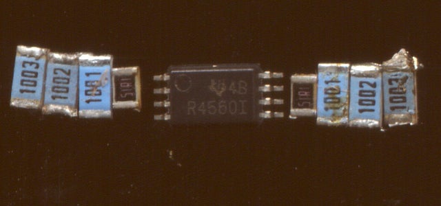

Step 3: The Components
The picture shows the integrated circuit and resistors. The chip is a free sample from Texas Instruments, and the resistors are all scrounged from old hard drives. The four digit marking means they are all of 1% tolerance, and they might even be MFR (metal film resistor). There is absolutely no way to confirm this, however.
The small size of these components make it very difficult for conventional point to point wiring techniques to be used. In fact the only viable means of connecting them up is to use a printed circuit board.

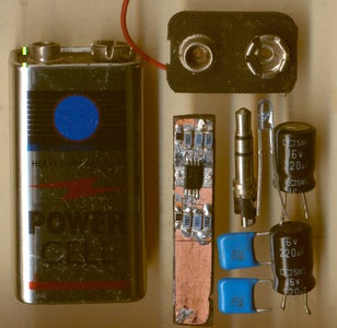

Now that the board is complete, it is time to look for the other components which shall make up the headphone amplifier.
A 9V battery has been included as a reference for size. The top off a dead 9V battery is used for the battery connector. A broken stereo jack shall be processed into the input connector. A volume control has to be harvested from somewhere. I am still in the field, looking out for one. A bright green LED that gives out a satisfactory amount of light when fed with 10K from that 9V battery has been selected. The two input capacitors are 150 nf (0.15 microfarads) which is 50% more than specified, and so adequate for the purpose. The two electrolytics have voltage ratings of 16 volts, and so they will be okay in this circuit which has a maximum of nine volts.
I am also in the lookout for a container for these bits and pieces. For a demo, a transparent case should do, though a metal case should be used for the sake of shielding.
