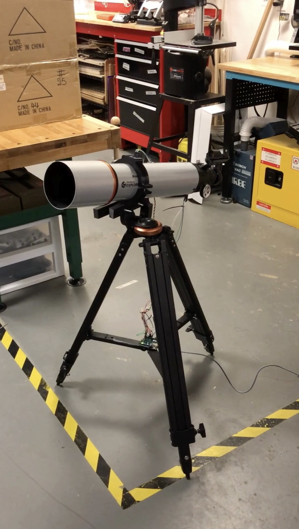

Introduction: Open Access and Open Source Motorized Telescope Mount
I’ve always wanted a motorized telescope mount but could never justify the steep cost. So, I decided to combine my passion for astronomy and innovation to create something more accessible, and I’m excited to share it with you. This project transforms a regular manual altazimuth mount into an automated system that can adjust both altitude and azimuth to point at stars, planets, and other celestial objects. Instead of making manual adjustments, you simply set the coordinates, and the telescope moves on its own!!

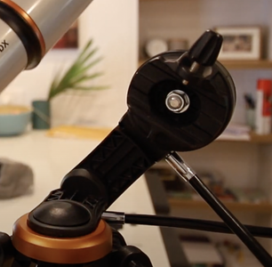

Step 2: Removing the Slow-motion Controls
After the telescope is removed unscrew and take off the slow-motion controls attached to the mount. Please refer to the quick setup manual to correctly deconstruct the telescope.

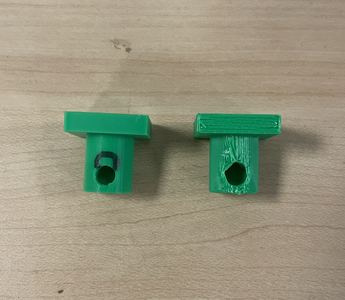

Step 3: 3D Print Motor Mounts and Sensor Clamp
After removing the slow-motion controls and detaching the telescope from the mount, you can print the motor mounts, servo connector, and ring clamp for the sensor.
I designed these parts in Fusion 360 (see files below), testing different configurations to ensure the motors fit properly without interfering with the telescope's movement. The ring clamp is tailored for a 102mm telescope and is compatible with the BNO055 sensor.
Printing Recommendations:
Infill: 20%
Resolution: 0.15mm
Supports: Tree supports
Once the parts are printed, clean off any supports and glue (if used). The motors should fit snugly into the mounts with minimal movement, and the ring clamp should fit securely around the telescope. Use screws to fully attach the ring clamp to the telescope. If you run into issues there is a Troubleshooting section at the bottom

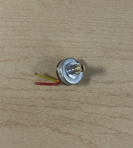

Step 4: Making the Servos Continuous Rotation
For this project, we have two different types of servos; however, neither of them is a continuous rotation servo.
Let's start with the HS-311. For this step, you should follow this tutorial by Chris Wilkinson, it is very helpful and easy to follow.
The HS-788HB servo is a bit more challenging to modify. Here’s how to do it:
1. First, unscrew the back cover (just as you did with the HS-311 servo).
2. You will not be able to remove the circuit board from the servo, so DO NOT attempt to take it out! You will only need to slightly bend it open to access the wiring inside.
3. Once you can see inside, take a small screwdriver or any item that can fit inside and carefully scoop out the three wires. They should be red, green, and yellow.
4. After you have scooped the wires, gently pull them out. If done correctly, the potentiometer should come off.
5. After completing these steps, your servo should now function as a continuous rotation servo. For easy access, I did not screw the back cover back on, but it’s okay to do so if you did.

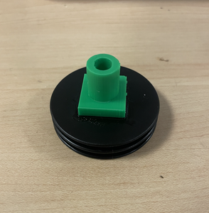

After 3D printing, you should have two rotary knobs. These will be used to connect the servo to the metal knobs on the telescope that control the gears.
Then use a soldering iron to heat the M6 nut, then use pliers to push it down into the knob, allowing the nut to sink in completely. If done correctly, you should be able to screw in an M4 screw that is 8mm long. For the HS-788HB servo, I needed to glue a spool onto the knob to ensure a proper fit. For the HS-311HB servo, I needed to screw in a servo hat into the knob to connect the servo to the knob.
After setting up the servo knobs, screw the knob into where you removed the slow-motion controls.

Step 7: Ring Clamp and Bno055
Once your servos and their mounts are set up and attached, we can proceed to set up the ring clamp and the BNO055 sensor.
1. Place the top clamp with the sensor area facing upwards.
2. Insert and align the BNO055 sensor into the holding area on the top clamp. Adjust its placement to match the reference image, ensuring the arrows point toward the end of the telescope, indicating the direction of view.
3. Use an adhesive (I recommend Krazy Glue) to secure the sensor in place.
4. Once the adhesive has dried, attach the ring clamp with the top clamp on top of the telescope using M6 screws. These screws worked well for me, but any suitable screws should be fine.
