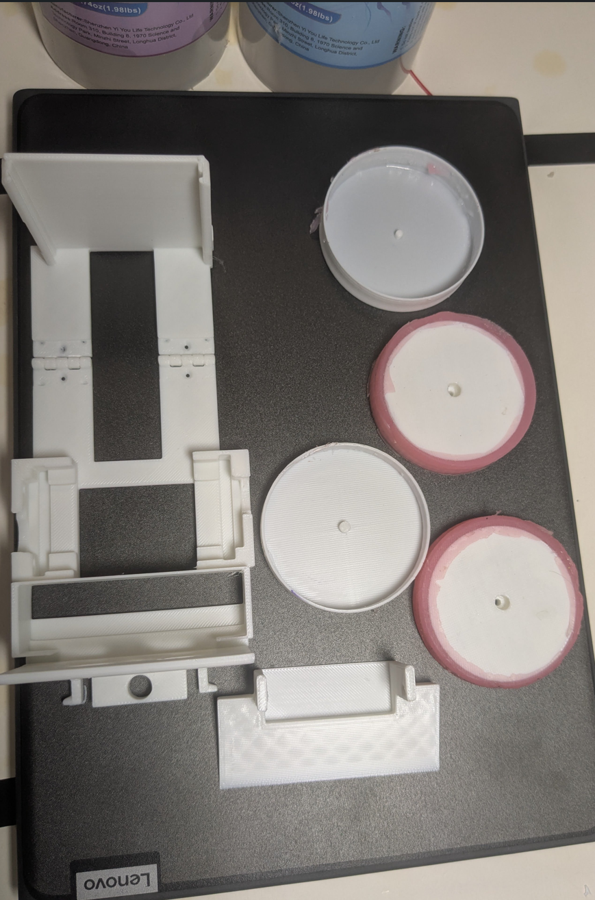

Step 1: 3d Print the Basic Parts-snap in Motors
Step 1- Print the attached basic 3d files. (You can save the Accessory files for later printing as students want to mod their robots). Fit the nano in the expansion board. Snap the servo motors into the chassis.
This friction fit for the servo motors will hold for normal use and to get started. But.... for long term use/ heavier abuse I do recommend attaching the motors with their included screws.

Step 5: Build and Install Wheels (for Rubber Tires)
Finish the build.
Wheels - I recommend silicone rubber tires molded over the 3d printed wheels. It’s fun (a bit messy) and very easy to get good results.
If you are only driving on soft carpets, the 3d printed wheels or other plastic wheels will work ok. For slicker surfaces, silicone rubber molded wheels add much, much better traction. 3D print the mold, mix the silicone (typically 1:1), place the 3d printed wheel into the mold, fill with silicone, wait four hours, then run an exacto knife around the outside edge to release from the mold. Note the holes in the 3-d printed wheel. These allow silicone to enter the wheel, bond and firmly attach. The tire comes off the mold, not off the 3d printed wheel. Pull the wheel and tire out of the mold. You have a soft, high traction tire at a very low cost.
Encourage the kids to customize tires and wheels.
Again depending on your printer tolerance, friction fit for the wheels on the motor may work for normal use. Otherwise use the screw that comes with the servo motors to attach the wheel. If this is not long enough, M2.5x6 bolts are available from Amazon and other sources.
