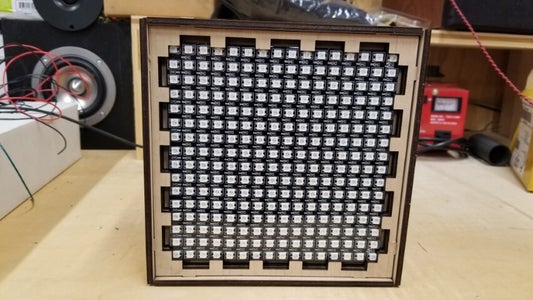

OK, I admit we are LED junkies, any project with bright shiny programmable Light Emitting Diodes gets our attention. From our Open Enigma to our Open DSKY, the more LEDs, the better! So how about 256 (or 1024 in our Quad unit) individually programmable RGB LEDs (NeoPixels)!
Oh Yeah! That is the fun part!
However, in today’s world, there are so many options for LEDs, it can be mindboggling to choose the right solution. We knew we wanted individually addressable (NeoPixels) LEDs so we could control each LED brightness and color separately for maximum flexibility.
We knew we wanted 5 Volts for Arduino compatibility.
We experimented with various strips of different densities until we landed on the flexible panels we use. The 8 x 32 panel is ideal for the Kitchen counter herb garden, while the square 16 x 16 is ideal for a bigger area and the quad at 32 x 32 LEDs can light up an even much bigger area.
As you build your unit, you could choose to use instead any strip density of Neopixel 5V RGB LEDs. They don't need to be waterproof, but it they have an adhesive backing, this may come in handy in your project. Just remember to tell the code how many Neopixels are there to control.

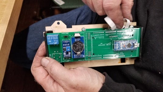

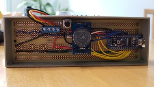

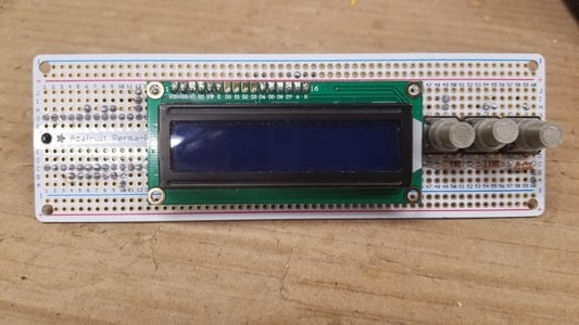

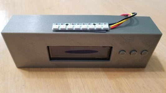

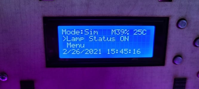

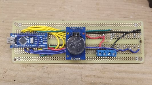

Our first prototype only had a 1602 LCD with an Arduino Nano and an RTC (Real Time Clock). This Proof of Concept worked like a charm, we knew we were on to something. However, we quickly realized we need a bigger screen, a temperature sensor, a moisture sensor and a water pump. We also added relays to control a heater circuit and a cooling device
Here is our schematic.
You can use a full size Perma proto board from Adafruit if you want to build a basic unit, however if you desire a full fledge Open Grow System, you will need a bigger platform to fit all components.

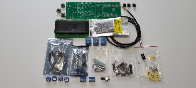

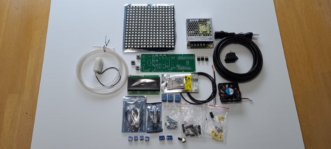

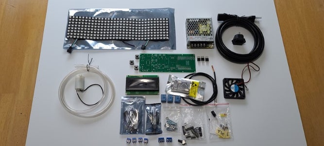

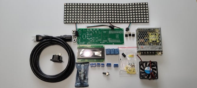

Bill of Material to populate your main board (or our PCB):
Qty Item
- 1 2004 LCD
- 1 Mega2560 Pro Mini
- 3 PushButtons 5mmx5mm
- 3 Relay 5VDC
- 1 VA RTC+2032 Batt
- 1 Moisture Sensor/Probe
- 1 Dallas 18b20 Temp Probe
- 1 Pot 10K 12.5mm
- 3 IRF510
- 4 ScrewAdaptorx2
- 2 ScrewAdaptorx3
- 3 40 Female Pins
- 1 40 Male Pins
- 4 470 Resistor
- 4 1K Resistor
- 1 4.7K Resistor
- 3 100K Resistor
- 1 Diode IN4007
- 1 Cap 1000uF 16V
Bill of Material for the enclosure contents:
- 1 256 Neo LED Panel
- 1 Power Supply LR550-5
- 1 AC Plug/Cord w/1A Fuse
- 1 5V Fan
- 1 5V Water Pump
- 1 Aquarium Tubing
We wired the:
- Neopixels on Pin 3
- LCD on (4, 5, 9, 8, 7, 6); //rs,en,d4,d5,d6,d7
- Dallas Temp Sensor (One Wire Bus) on 13
- Heater Relay on 12
- Fan Relay on 11
- Water Pump on 10
- Reed Relay (Moisture) on 2
- Buttons on A2
- Moisture sensor on A3

Coding this thing in Arduino to make it fit on a Nano has been lots of fun, to say the least.
We found out quickly that the Nano does not have enough memory to control 1024 Neopixels.
Once we upgraded to the Mega2560 Pro we are now using, this problem immediately went away. We then were able to add all the functionality we desired.
My favorite part was the season simulation for any latitude on the planet for the whole year. This required to create a sunrise/sunset table (stored in the EEPROM) for the whole year to be used to derive YOUR sunrise/sunset times for YOUR location.
HINT: The sunrise and sunset time for any latitude will fall between the Artic Circle and the Equator.
You will need 3 different Arduino sketches.
First, you need to wipe to zero all locations in the EEPROM using the EEprom_Clear code available @ Arduino.cc.
Then you need to run our DayLenghtSet INO file, which will load the EEPROM with all 365 daylight length durations, required to calculate the sunrise and sunset for anywhere on Earth.
Finally, you need to load our Production code that runs the interface, controls the light and read moisture sensor and starts/stops the water pump based on your desired moisture level.

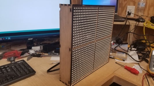

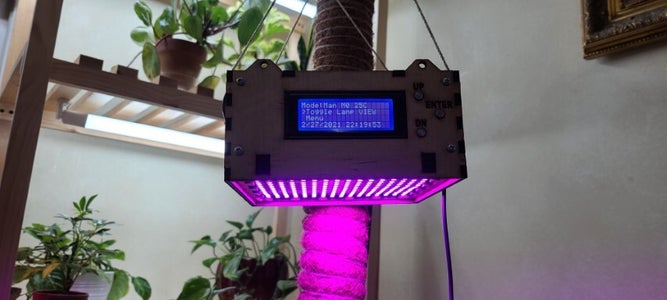

We have evolved the enclosure repeatedly during each iteration of the design process. From the original 1602 LCD barebones unit with the Arduino Nano unit on a proto board to the final Mega2560Pro on our 3rd generation custom PCB, the enclosure has continued to improve. We started with a 3D printed box for the LCD and brain only and moved to a lasercut enclosure for the whole assembly.
The current lasercut enclosures are flexible, streamlined and provide ideal visual appeal while containing the electronics in the minimum amount of space. Special consideration has to be given to air flow.

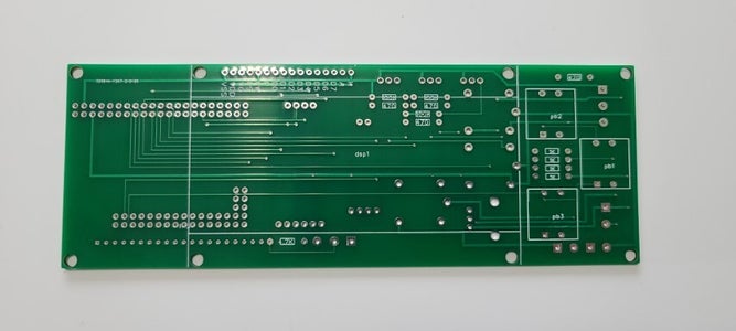

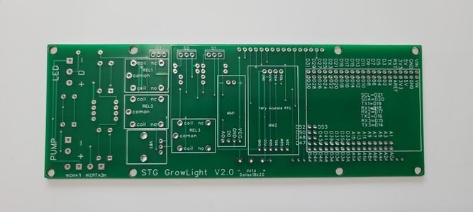

Step 6: PCB
Of course, if you build multiple units, you need a PCB for reliable repeatability. 3 PCB revision later, we have our full featured Printed Circuit Board. Available at a low price, this will cut your headaches and DIY time by a lot!
