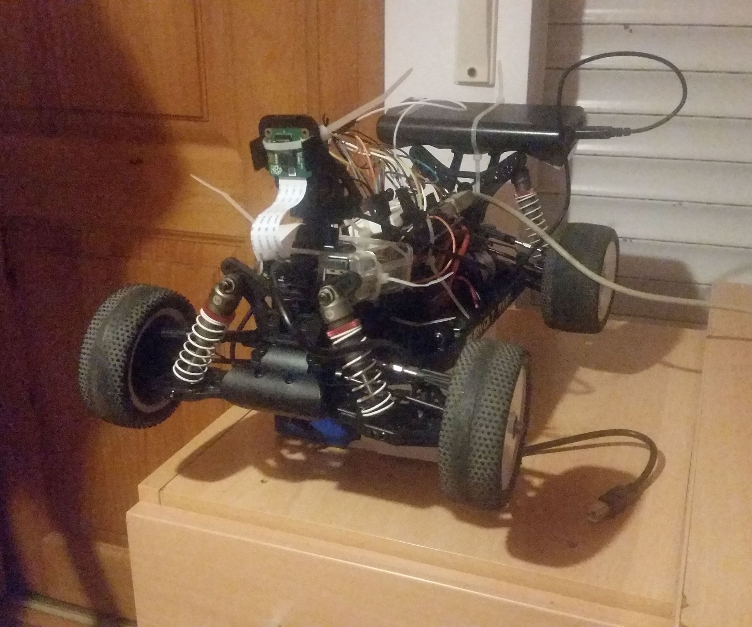

Introduction: Open Hardware Rover With OpenCV
In this lines you can read how build a rover using opencv for do something detecting colors.
The work process is simple, Arduino have a basic program to the rover: forward, left and right that manages the movement in the rover.
The Arduino board is connected to a Raspberry pi by USB port and RPI send data from serial port:
For example, if the RPI process the image and the center of the target is in the left side of the image, the RPI send a command to the Arduino for move the wheels to the left. If the target is far ( the high of the object is little) the RPI send the order forward while the target isn't big.

In this case you have two options:
1.- Use RC car (this have been my option)
2.- Build your own rover platform:
2.1- using brushless motor + ESC + servo
2.2- using motor + servo
2.3- using that you want

Step 6: Final Set Up
In this step you have to connect the Arduino to the Raspberry Pi for USB port, because the python program use the serial port to send movements to the Arduino board.
And this is the python program that manages the opencv processing and send data to Arduino:
Now you can enjoy the project!
