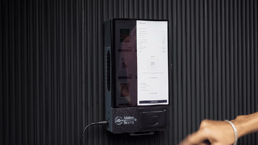

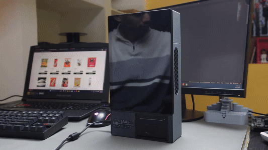

Introduction: Open Kiosk
Open Kiosk: Build Your Own Smart POS System for Retail Stores
Are you a small business owner, market vendor, or pop-up shop operator looking for an affordable, professional, and open-source point-of-sale system?
Look no further, Open Kiosk is here! This DIY project walks you through building a complete retail kiosk powered by modern web technologies and real hardware components, all without recurring fees or vendor lock-in.
With Open Kiosk, you can:
✅ Add and manage inventory
✅ Print thermal receipts
✅ Track sales and generate reports
✅ Use voice search
✅ Customize everything to suit your shop

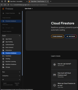

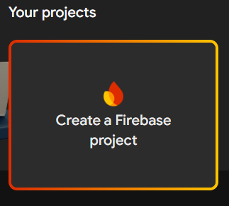

It is powered by a free Firebase database (Limited to 50,000 reads/day, 20,000 writes/day, 1GB storage). The app is highly optimized, capable of storing over 10,000 products and 50,000+ order history entries within that 1GB limit.
Whether you're setting up a boutique, food stall, or mobile kiosk, this project helps you create a reliable and sleek POS system using components like a LattePanda MU, ESP32, and a thermal printer, all housed in a compact 3D-printed enclosure.

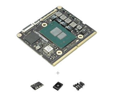

- Hardware: LattePanda MU, Seeed Xiao ESP32 S3, 58mm/80mm thermal printer, touchscreen display, 3D-printed case

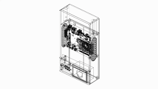

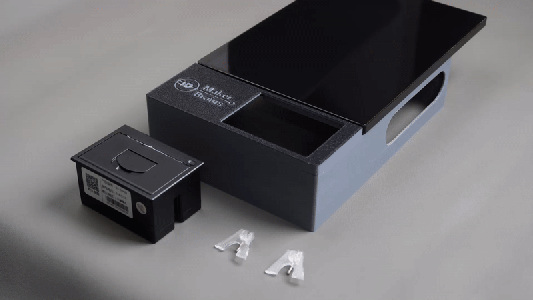

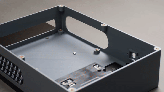

Step 1: CAD and 3D Printing
I designed the custom enclosure for Open Kiosk using Fusion 360 to ensure a compact, modular, and professional look.
CAD Modeling Process
- I started by importing official CAD models for components like the LattePanda MU.
- For parts without available models (e.g., thermal printer, connectors), I measured them manually and used datasheets to create accurate 3D models.
- Once all components were modeled, I began designing the enclosure to precisely house each part.
Enclosure Design Overview
The enclosure includes several modular parts:
- Housing – Main frame to hold the display, LattePanda, ESP32, and wiring
- Printer Cover – Mounts to the housing and secures the thermal printer
- DC Connector Holder – Allows the DC jack to be screwed firmly into the housing
- Button Clip – Holds the push button securely in place
- Side Vents – Provides airflow for cooling

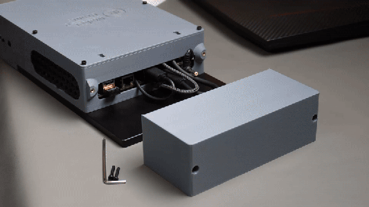

- Cover – Bottom cover to enclose the internal components
- Top Cover – Hides the exposed ports on top for a clean finish
3D Printing Details
All parts were printed on my Bambu Lab P1S using PLA+.
- The design supports metal heat inserts, so each part can be assembled using standard M2 and M3 screws.
Download Files
You can either edit the original design in Fusion 360 using the provided CAD files or directly print using the .STL files below:
- 1x Housing.stl
- 1x PrinterCover.stl
- 2x SideVent.stl
- 1x DCHolder.stl
- 1x ButtonClip.stl
- 1x Cover.stl
- 1x TopCover.stl
OpenKiosk

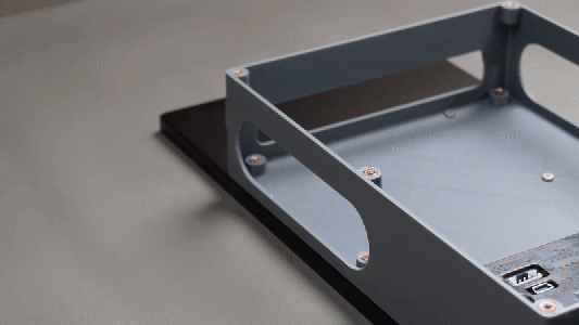

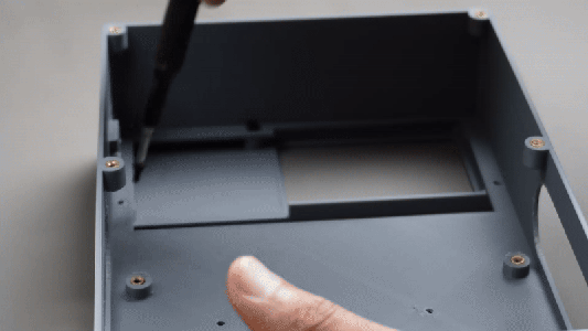

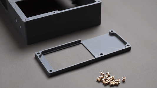

Step 2: Embed Heat Inserts
Before assembling the parts, we need to embed metal heat inserts into the 3D-printed parts. These allow us to screw everything together securely without damaging the plastic.
What You will Need:
- 11x M3 x 6mm heat-set inserts
- Soldering iron (preferably with a heat insert tip)
- Tweezers or pliers
- Housing and PrinterCover
Embedding Process
- Power up your soldering iron and set it to around 180–200°C (or according to your insert manufacturer’s recommendation).
- Place an insert on top of each designated hole in the Housing and Printer Cover parts.
- Using the tip of your iron, gently press down on the insert. Apply steady pressure until the insert slides flush into the plastic.
- If you're using a standard soldering tip (like I did), carefully hold the insert in place with tweezers while heating and pressing it in.
- Let it cool for a few seconds before moving on to the next insert.

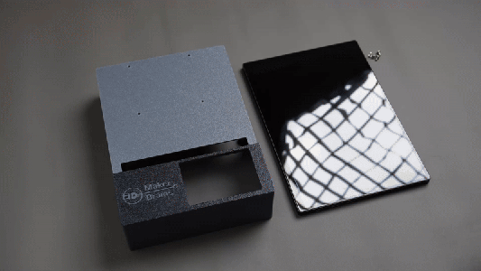

Step 4: Assembling the Display
Time to mount the touchscreen display onto the main housing.
What You will Need:
- Housing (main enclosure)
- 10.5" Touchscreen Display
- 4x M2.5 screws (included with the display)
- Screwdriver
Assembly Instructions:
- Align the display with the pre-designed mounting holes on the Housing.
- Insert the M2.5 screws and tighten all four screws evenly, one at a time.

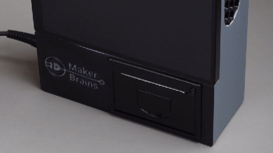

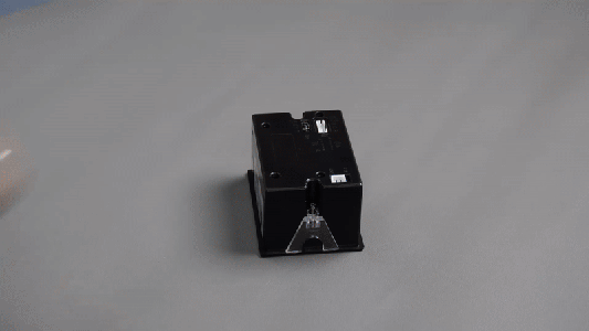

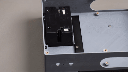

Step 5: Assembling the Thermal Printer
Now we will install the thermal printer into the enclosure.
What You will Need:
- Thermal Printer (58mm or 80mm)
- Screwdriver
- Assembled Housing + PrinterCover unit
- Use a screwdriver to carefully unscrew and detach both side mounting brackets from the printer body.
- Insert the printer into the PrinterCover opening.
- Screw the clips back, to secure the printer firmly to the housing.

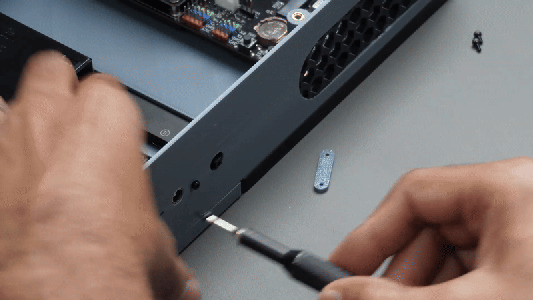

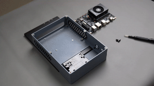

Step 7: Assembling the LattePanda MU
Now it's time to install the brain of your kiosk, the LattePanda MU board. This powerful mini-PC handles the entire software stack of Open Kiosk.
What You will Need:
- LattePanda MU (assembled board)
- 4x M3 x 6mm screws
- Assembled Housing
- Screwdriver
- Position the LattePanda MU inside the housing.
- Align the board so its mounting holes line up with the M3 heat inserts embedded in the housing.
- Insert 4x M3 x 6mm screws into the mounting holes.
- Tighten the screws evenly until the board is firmly mounted to the enclosure.

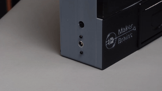

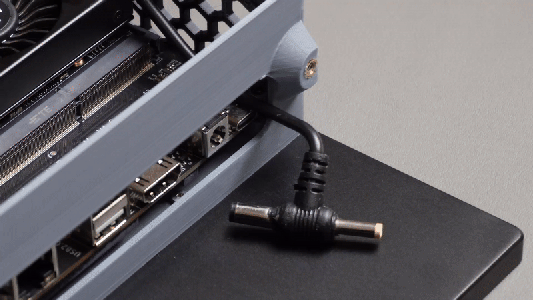

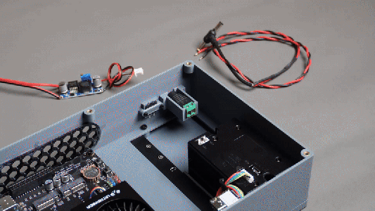

Step 8: Assembling the DC Connector & Power Button
Now let's install the power input (DC connector) and the push-button power switch.
What You will Need:
- DC Female Connector
- 3D-printed DC Holder (DCHolder.stl)
- Push Button
- 3D-printed Button Clip (ButtonClip.stl)
- 4x M2 x 6mm screws
- Screwdriver
Part A: DC Connector
- Insert the DC connector into the 3D-printed DC holder, it should snap in snugly.
- Align the DC holder with the dedicated mounting slot on the housing.
- Secure it with 2x M2 x 6mm screws.
Part B: Push Button
- Insert the push button into the slot on the housing.
- Place the 3D-printed button clip over the button from inside the housing to hold it in place.
- Secure the clip using 2x M2 x 6mm screws into the matching holes.

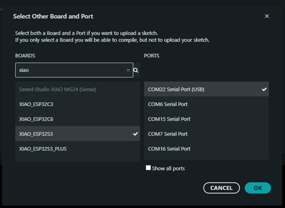

- Select the Right Board:
- Go to Tools → Board → ESP32 → Select XIAO ESP32S3
- Go to Tools → Enable "USB CDC On Boot"
- Connect Your Xiao ESP32 via USB-C cable
- Select the Port:
- Go to Tools → Port and choose the COM port labeled with “ESP32 S3”
- Upload the Code:
- Click the Upload button
- Wait for the code to compile and upload.

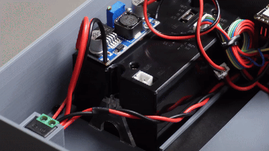

Step 11: Connecting Power
This step ensures power delivery to both the LattePanda MU and the thermal printer from a single 19V power supply.
Required Parts
- Male DC Connector (connects to MU)
- DC Female Connector (already mounted on enclosure)
- LM2596 Buck Converter Module
- 2-pin JST Connector (Included with printer)
- Multimeter (to set voltage)
From the female connector, split the power wires:
- One pair goes directly to the LattePanda MU via the male DC connector.
- One pair goes into the IN+ / IN− of the LM2596 module.
Step-Down Conversion for Printer:
- Adjust the LM2596 output to ~8V using a multimeter and the onboard potentiometer.
Power Connection
- Connect OUT+ / OUT− to the 2-pin JST going to the thermal printer.
- Plug the 2-Pin JST Connector into the thermal printer’s power input.
- Connect the Male DC Barrel Jack to the LattePanda MU’s DC input port.

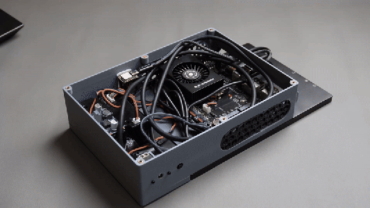

Step 12: Connecting Display & ESP32

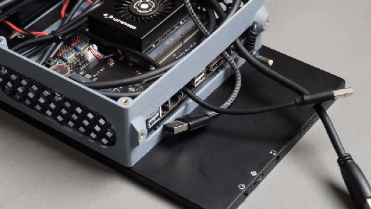

- Connect an HDMI cable from the LattePanda MU HDMI port to the Micro HDMI port on the Touch Display. This handles the video signal.
- Use a USB Type-A to Type-C cable to connect from the LattePanda MU USB Type-A port to the Touch Display Type-C port. This supplies power to the display.
- Use a USB Type-A to Type-C cable to connect the ESP32 Type-C port to another USB Type-A port on the LattePanda MU. This powers ESP32 and allows the MU to communicate with and program the ESP32.

Step 14: Enclosure Cover Assembly
- Take the enclosure cover and carefully align it over the housing.
- Make sure that all holes in the cover line up with the threaded inserts on the housing.
- Use 6x M3x6mm screws and use a screwdriver to gently but firmly tighten the screws.
Step 15: Assembling Top Cover
- Since the LattePanda MU doesn't have a built-in WiFi card, we are using a WiFi USB dongle.
- Plug the USB dongle into one of the available USB ports on the MU (preferably a USB 3.0 port for better performance if available).
- Take the Top Cove, align it with the enclosure assembly, ensuring that no cables are in the way and the screw holes are properly lined up.
- Use 2x M3x16mm screws and an L-key (hex key/Allen wrench) to tighten them securely.
That is it, our hardware assembly is complete!
Step 16: Power ON
- Plug in the 19V Power Supply that came with our LattePanda MU kit into the female DC jack on our assembled enclosure.
- Press the external power button.
- Wait a few seconds, the LattePanda MU should begin booting up.
- The display should turn on, and if connected properly, your thermal printer should be powered and ready.
No power?
- Check the DC adapter is firmly connected.
- Make sure all power connections (especially the LM2596 module) are secure.
- Verify the LM2596 is still outputting ~8V to the printer.
Display not turning on?
- Confirm HDMI and Type-C power to the display are connected.
- Double-check that the LattePanda MU is booting (look for fan or LED indicators).
Thermal printer not working?
- Ensure the JST connector is seated properly.
- Verify the LM2596 output again with a multimeter.

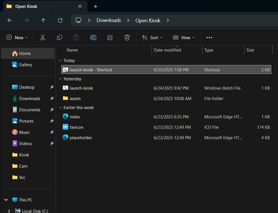

- Extract the Open-Kiosk.zip file to a folder of your choice (e.g., C:\OpenKiosk)
- Edit the Launcher:
- Open launch-kiosk.bat in a text editor (e.g., Notepad)
- Update the path to point to your extracted folder
- Save the file
Example line you might edit:
Replace "C:\Users\YourName\Open Kiosk" with your actual extracted folder path.

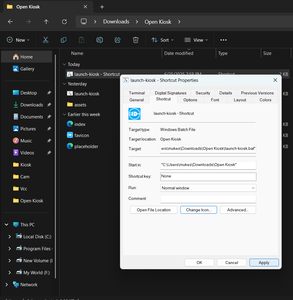

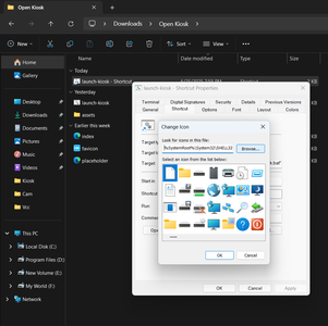

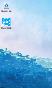

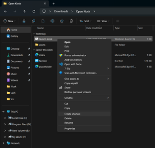

Create a Desktop Shortcut
- Right-click launch-kiosk.bat → Create shortcut

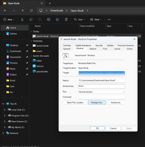

- Right-click the new shortcut → Properties

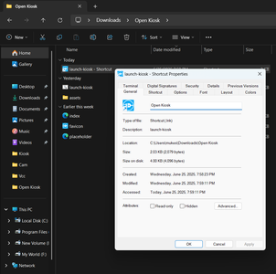

- Click Change Icon → Choose icon from the extracted folder favicon.ico
- Rename the shortcut to 👉 Open Kiosk
- Drag or copy the shortcut to your Desktop or Home screen
✅ Done!

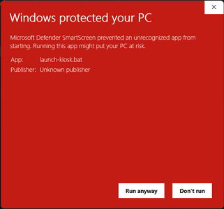

- Double-click the Open Kiosk desktop shortcut you created earlier. If You Get Warning the click on run Anyway.
- You will be presented with the Initial Store Setup screen (as shown in the image). Here's how to complete it.

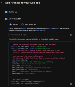

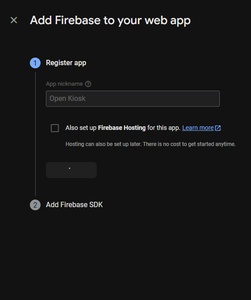

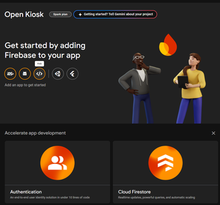

Firebase Configuration Setup
- Go to 👉 https://console.firebase.google.com
- Log in with your Google account
- Click “Add Project” → Create a new Firebase project
- Under “Your Apps” → Add App → Web
- Register your app (e.g., open-kiosk-app)
Copy these values from the SDK config and paste them into the setup form:
- API Key ~ apiKey field
- Project ID ~ projectId
- Auth Domain ~ authDomain
- Storage Bucket ~ storageBucket
- Messaging Sender ID ~ messagingSenderId
- App ID ~ appId
Once all values are entered, click “Complete Setup”
Create Firestore Database
- Go to Build → Firestore Database in Firebase
- Click Create Database
- Choose Start in Test Mode
- Select your region and click Enable
