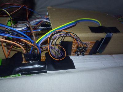

In the images you can see a diagram of the Open MIDI guitar and some photos of my prototype. The MPR121 modules are controlled through I2C, and each one provides 12 capacitive sensors. We need as many frets as we can, but we can only connect up to four modules per I2C channel. The ESP32 has two I2C channels, so this microcontroller can control the impressive amount of 96 input capacitive sensors: 90 for the fretboard and 6 for the strings. MPR121 modules and ESP32 controller work at 3.3v.
Physically, we can divide the design into four parts:
- Fretboard and strings.
- Microcontroller block.
- Sensors block.
- User interface block.
I have used female pin headers to connect the MPR121 modules and the ESP32 to their respective perfboards. I recommend a glue gun to fix these pin headers to the perfboard before soldering them. The blocks are interconnected using dupont cables, so that they could be interchanged for other blocks. From the microcontroller block, six dupont cables are connected to the sensors block: VCC, GND and the four lines needed for the two I2C channels. Another four cables are connected to the user interface block, for controlling the buttons. Finally, another four cables are connected between the sensors block and the user interface: VCC, GND, and the two cables of I2C channel one.

I have used a small perfboard and female pin headers to insert the ESP32 module in. I soldered some male pin headers too, for dupont cables connections. I used pins 4, 0, 2 and 15 for the buttons; and pins 25, 26, 27 and 14 for the I2C channels. Among the photos, you can see the initial complete prototype with this block already soldered.

As you saw in previous photos, I initially used a small breadboard with the four buttons and the display for this block, and it worked fine. I decided to use a perfboard here too, but divided it in two parts: one for dupont lines interconnections, and the other for the buttons. I did this because I didn't want anything higher than the buttons in the board, so i could put these into a perforated cardboard box or something similar. At the end, I used insulated tape, so the result isn't pretty at all :-). At least these small perfboard pieces are ready for something better.
