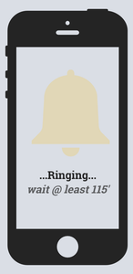

When the user accesses the website, an ajax call is performed which changes the contents of a .txt file to "on". The Raspberry Pi checks this file every second. If it detects a change, it plays the sound and changes the contents of the .txt file to "off". The web interface then updates to tell the user that the bell has rung.

Step 2: Web File Upload
Create a directory on your web server & add the files in the folder "web.zip". You can use an FTP client (e.g. Filezilla).
When visiting http://yourwebsite/directory you should see the interface.
The folder web.zip contains 6 files:
- index.html : the main entry point. contains the DOM structure
- style.css: the css
- status.txt: a text file storing the values "on" or "off" depending on whether the sound has been played
- ajax.php: php scripts to check the status.txt file
- script.js: js scripts to perform ajax calls
- doorbell.svg: icon to display on the screen
