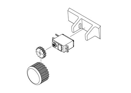

Next, assembly a servo with the smaller gear and the base. We tightened servo with 4xM3 screws. Then attach it above a door locker, so it will be able to move correctly. We used tape to attach the base with the servo to a door above the lock. Bear in mind, that the program will be starting at the open position, so unlock the door and make sure, that the servo is in a correct position before assembling gears togheter. The best is, to do it after programming, so the servo will be in the desired position.

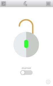

Use our User interface to controll your door via web browser.
