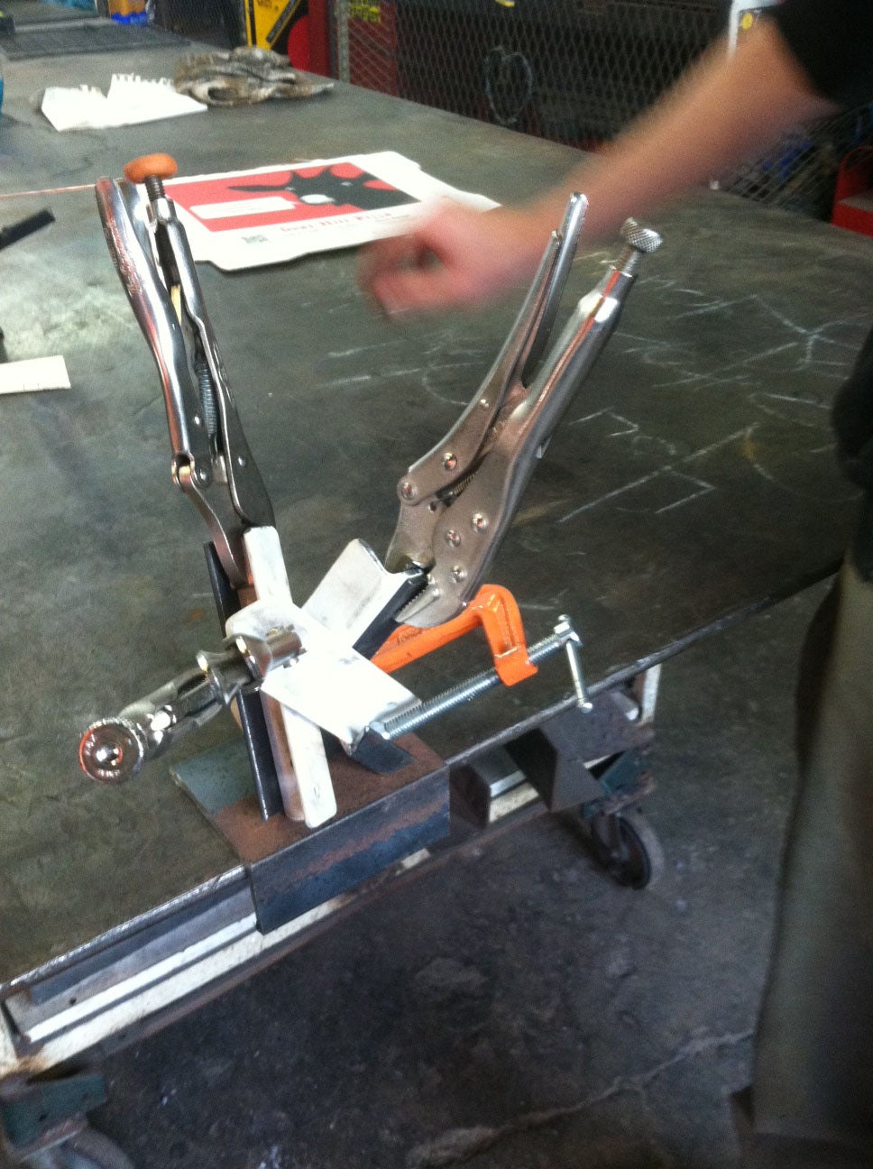

Step 3: Rig the Jig
Take your Catalyst and clamp one bit of 3/4" angle iron to each side.
Make sure that the inside length of the 3/4" piece is flush with the edge of the Catalyst, and that the bottom is touching the table.

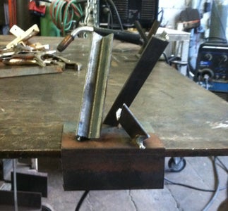

Step 4: Weld the Jig
Center the "Rigged Jig" on the 2" x 3" angle iron, or whatever scrap you have laying around.
Weld the points where the 3/4" angle iron touches the base.
You will want to build up the bead with a few passes to give it enough strength for repeated use.

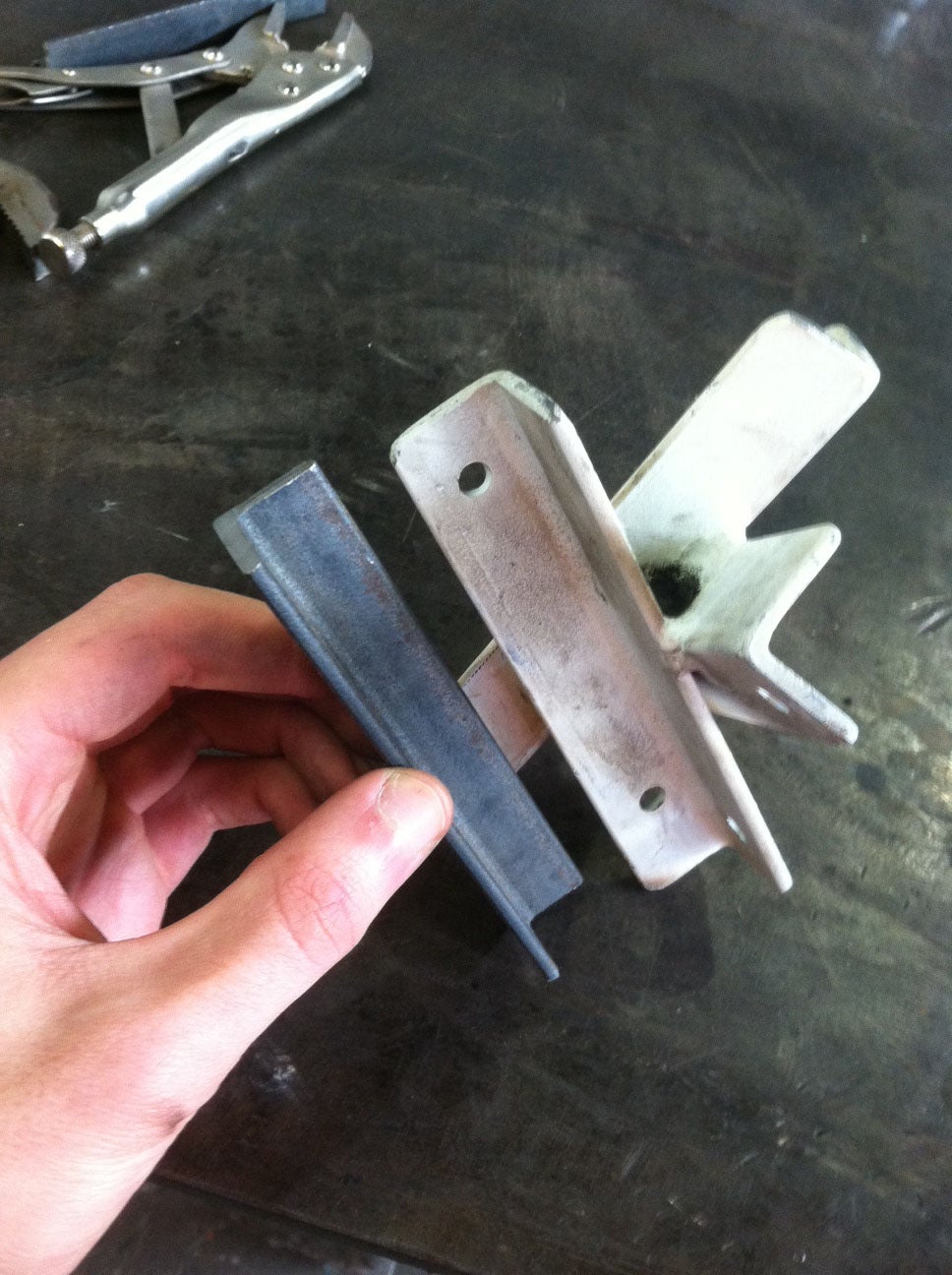

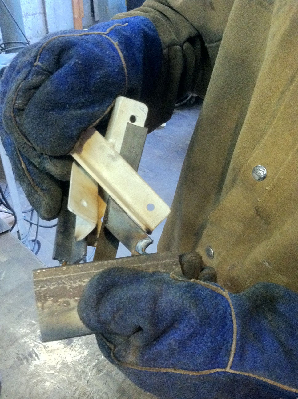

Step 5: Remove Catalyst
It should just slide right out, you may have to give it a little push... with a hammer. If you do, don't worry, this is entirely normal.

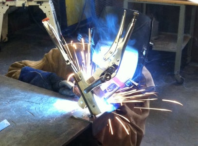

Step 7: Weld the Catalyst
Place three pieces of angle iron in the Jig.
Hold the pieces in place and slide the whole jig to the giant arrow magnet.
The pit of angle iron on the short end of the jig should be touching the edge of the magnet. This will help hold everything together.
Tack weld the corners.
Remove the tack welded Catalyst... may require a hammer.
Run a bead up the three inside seams (it works much better if you go up, rather than down).
Flip it over and weld the bottom just for fun.
