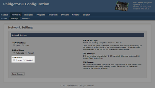

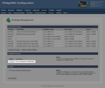

In order to use OpenCV on your Phidgets SBC you will first need to install the libraries and development files. To do this we need to configure the SBC a little bit, as seen in the first two images above.
Then connect to the SBC via an SSH terminal. Since our desktop computer is using Windows, we’re using PuTTY. Mac and Linux users can use the openSSH terminal application. If you are uncertain on how to connect to an SBC via SSH, we encourage you to check out our getting started on SBC video, which devotes some time to the topic.

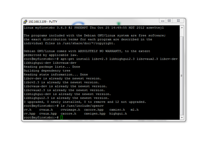

Once we’ve connected to the SBC, we’ll install all of the necessary openCV libraries with:
apt-get update
apt-get upgrade
apt-get install libopencv-core2.3 libopencv-core-dev libopencv-dev libcv2.3 libhighgui2.3 libcvaux2.3 libcv-dev libhighgui-dev libcvaux-dev
If apt-get cannot find these packages that may mean there are newer versions available. By running the following commands, you’ll be able to see if the version in the repository is something other than 2.3:
apt-cache search opencv
In order to make sure OpenCV installed properly, check to see that the files are in the right location.
ls /usr/include/opencv
In particular you are looking for cv.h and highgui.h. It’s possible that a different version of OpenCV may put highgui.h in a separate folder and give it a slightly different name (highgui_somecharacters.h). If you do not see both cv.h and highgui.h in /usr/include/opencv then you may have to search around a bit to find them.

If you are not copying and pasting these commands, but rather typing them out manually, then you need to ensure that you use backticks (`) rather than the more common front tick (‘). It may also be necessary to link to the highgui.h separately based on what path it got installed to (likely opencv2 or highgui) if you had to search for it previously. Note that since OpenCV is designed for C++ you will need to use g++ rather than gcc in order to compile. It should have been installed when we enabled the C/C++ development tools.

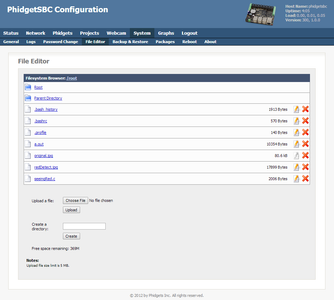

Getting these two images can be easily done with the file editor functionality of the SBC web configuration tool as seen in the third image.
