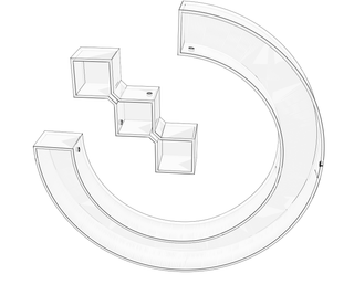

Step 1: 3D Design
First we need a 3D design. Our most talented designer, Jesus, helped out creating a gorgeous design with a top plate printed in transparent plastic and holes for cables and space for the circuit. Our plan was to design the most simple lamp we could, so no interruptors or batteries, just a micro usb connection for power. We used 123D Design which is a pretty easy to use software for 3D modelling.

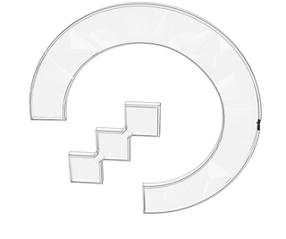

Step 2: 3D Printing
With the design in hands, we printed the base with grey PLA and the top plate, where the light must go trough with transparent plastic, also PLA. The two pieces must perfectly fit together with no screws or glue, at least that did in the original design. In the real world 3D printers are not that precise, so we had to scale a little bit down the top part that gets fixed in the base. That's called tolerance, and
