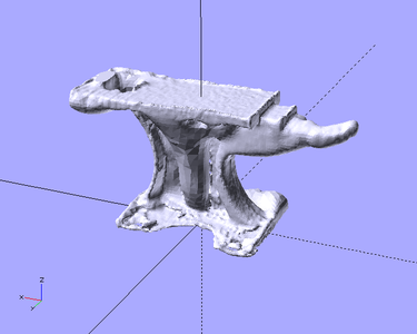

Step 1: Recreating the Original 3D Printer
I am starting a new business doing rapid prototyping. My partner was looking through the garage and found an anvil, he said "look the original 3D printer". We liked the concept and decided to use the anvil as a motif for our business.
It would be nice to have a 3D model of an anvil to print.
We scan a cute little anvil we found. The major brand scanner we have does a terrible job. OpenSCAD to the rescue.
I have uploaded the STL. Download it and play along with me.

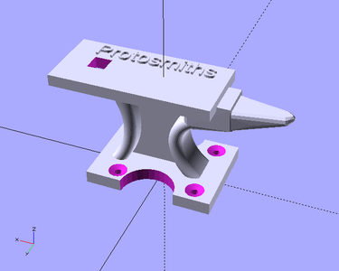

Step 18: Our Beautiful Anvil!
When you F6 compile the code we have written you will get
"PolySet has nonplanar faces. Attempting alternate construction"
This has happened to me every time I have used the sweep. It doesn't seem to cause a problem, because the compile completes and the object is manifold and printable.
These techniques have made a manifold 3D model. That is one of the side benefits of using the hull so much. Hulls are naturally manifold.
If I weren't writing this Instructable, recreating the anvil wouldn't have taken me very long. These techniques work very well for me. I hope that you will find these techniques are useful as well.
