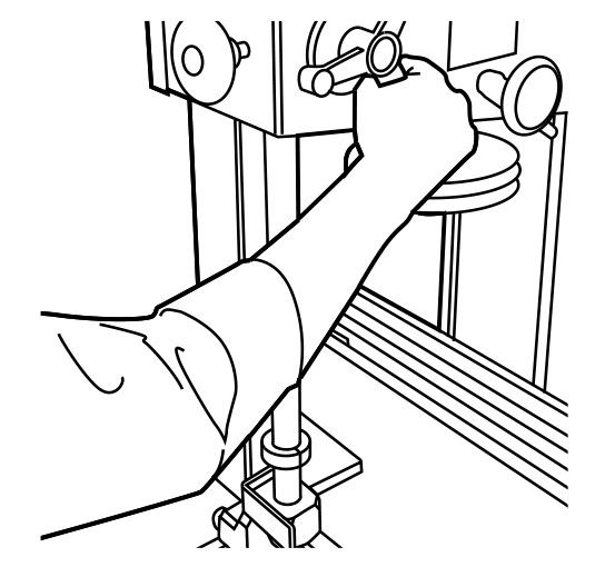

- Adjust the blade guard height.
- The height of the blade guide should be about ¼” above your material.
- The blade guard covers the blade and helps reduce the chance of injury
