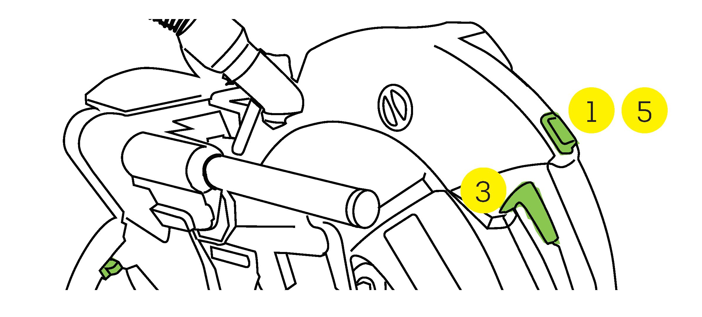

- Push down on the trigger interlock button with your thumb.

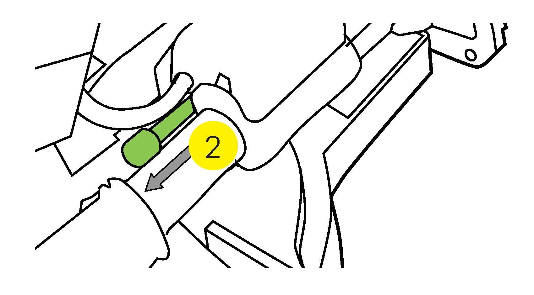

- Pull out the arbor lock button.
- Pull the trigger to allow saw movement.
- The blade will not start to spin.
- Pull the blade towards you, and down.
- The blade should not be touching the workpiece.
- Press the trigger interlock with your thumb to start the blade.
