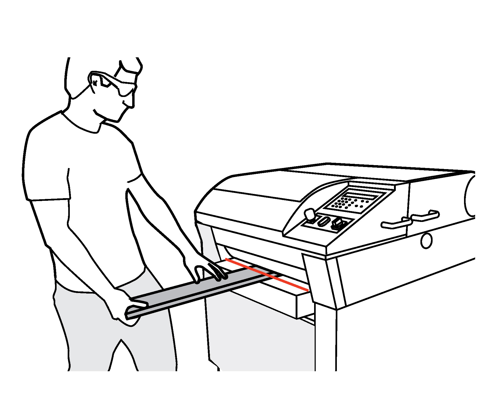

Step 2: Making the Cut
- Press the blade start button and wait for the planer to come up to speed and table to move.
- Slide the board into the machine and support the end if needed.
- Do not push or pull the board once the power feed has taken over.
- Go to the outfeed side (or have a partner help) and support the board as it exits.
- Readjust the table height and take another pass if needed.
- Maximum depth of cut is 0.06" (about 1/16").
