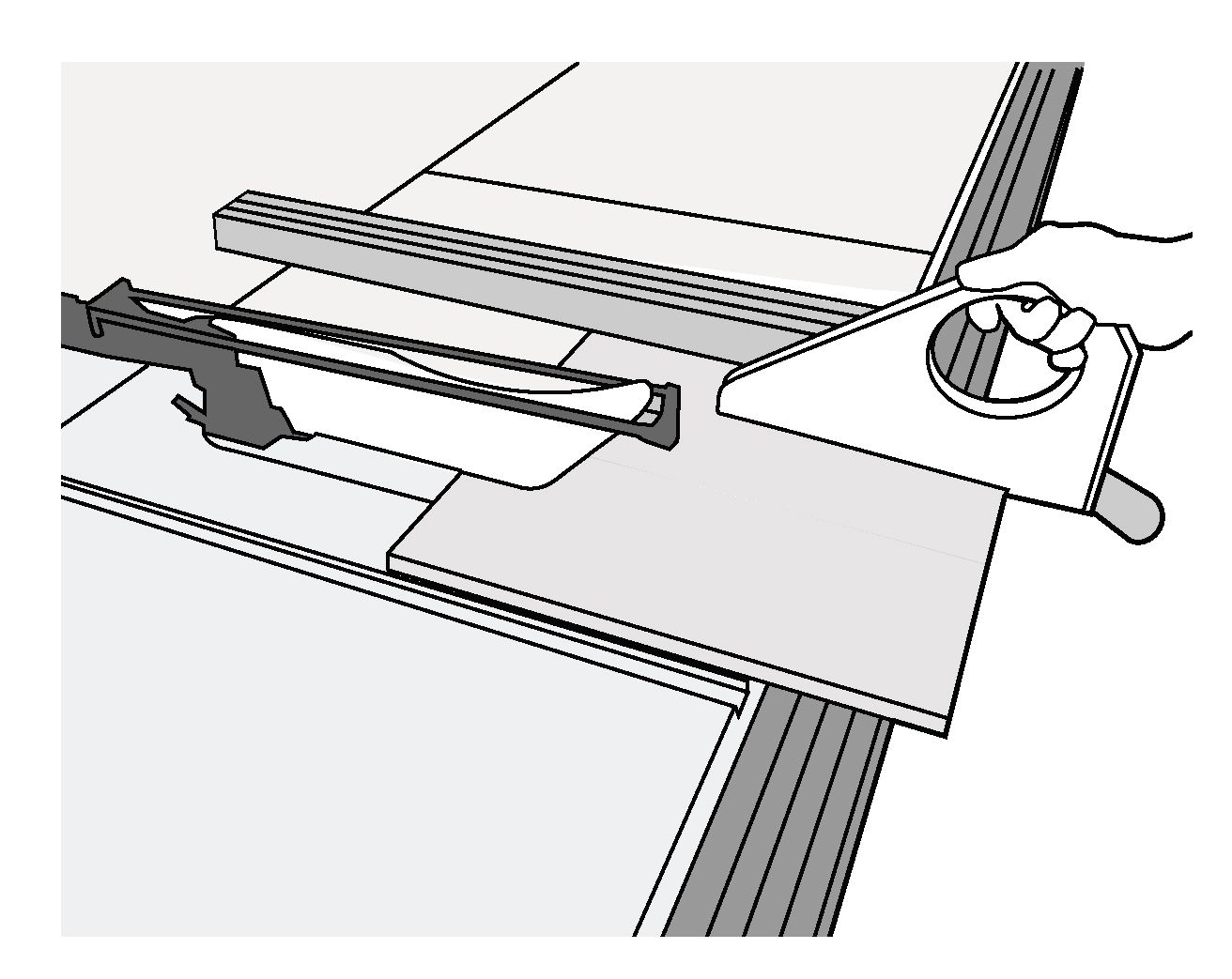

Step 2: Making the Cut
  1. Pull the red paddle to turn on the saw.
  2. Wait for the blade to come up to speed.
  3. Keep a straight edge of the material tight against the fence at all times.
  4. Slowly push the material into the blade.
    • Experience will help you determine the correct speed for cutting your material, depending on thickness, blade type and other variables.
  5. Keep at least one hand or a push stick on the material at all times; never completely let go.
  6. Stay in control of the material until it is past the back of the blade.
  7. Push the red paddle to turn off the blade, and wait for it to stop moving.
