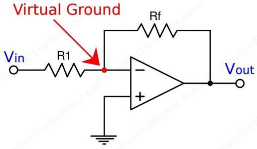

Step 3: The Concept of Virtual Ground:
In the closed loop configuration of the operational amplifier. The virtual ground concept is there in which operational amplifier tries to minimize the error of the applied input signal. Example: if the inverting terminal is held at ground potential, then the non-inverting terminal also assumed at ground and all the observations made according to it.

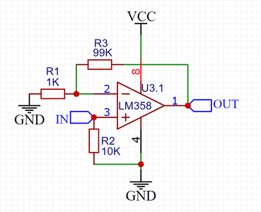

Step 4: Operation Amplifier in Non-inverting Configuration:
The signal input is given on the non-inverting terminal. On the inverting pin a resistor network of Rf (feedback resistor) and Rin (Input resistor) completes the circuit. While applying KCL on this circuit it is assuming that no current flowing through the terminals of OP-AMP and the input impedance of assumed to be infinity. Which set the overall gain of this configuration and given by 1+Rf/Rin.
Step 5: Inverting Configuration:
In this configuration the signal is applied on the inverting input after the resistor network. That is why the configuration is named as inverting one. And the non-inverting simply grounded(for reference). Because we are applying signal on inverting pin the output is 180 degrees out of phase to the input. Here the overall gain is given by -Rf/Rin.

Step 6: A Basic DC Amplifier Working Concept:
Let’s take an example where we have a signal of 10mA and we want to amplify the signal to 1 volt, so a gain factor of 100 is required.
Step 1: Choose the configuration, it is easy to work with both configurations but here I am choosing non-inverting configuration which gives a gain factor of 1+Rf/Rin.
Step 2: Choose the value of Rf and Rin according to the Gain.
Gain= 100
100= 1+RF/RIN (Assume Rin be 1k and calculate for Rf)
we required the RF= 99K, Rin=1k for the gain of 100
Step 3: Because in closed loop the operational amplifier tries to minimize the difference between both the input terminals. We need to give a reference from the non-inverting terminal to ground. This set a reference line and the gain is amplified by the same factor as of applied input signal. The AC amplifier holds a different approach which will be discussed in next tutorial of the series “Operational amplifiers are awesome”.
