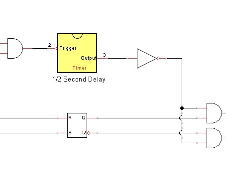

Step 3:
Here is the actual Ckt that I use: some buffers to create a slight delay of the Trigger Signal. The 555 is triggered with a negative pulse (from other control logic) creates a 3/4 Sec Pulse that ensures that the Shutter will fire.
The Camera Cable is a Nikon MC-DC2 plug on one end (plugs into the Camera) and a 2.5mm Plug on the other end (connects to the output from the Optocouplers).
