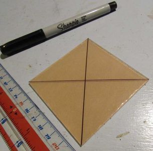

Step 1: Transparent Square
Choose an optically clear transparent plastic for the body of the center punch. I happened to use a:
- 3 inch by 3 inch by 1/8 inch piece of Acrylic
The piece should be as wide as the largest center you would expect to center punch. I would recommend choosing something thicker than 1/8 inch because it is rather flimsy. A 3/8 or 1/4 inch thickness is probably much sturdier. I would also recommend using polycarbonate because it is a more forgiving plastic.
More important than the material is making sure that it is square:
- Use a right-angle triangle or straight edge to check for square.
- Remove excess material using a hand plane.
When this is done, draw an X from corner to corner on the non-protected (clear) side of the plastic.

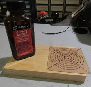

Step 3: Glue Base
In this step, secure the plastic piece to a base for further gluing with Silicone.
- Apply contact cement to the glue base, a piece of scrap wood, MDF, etc.
- Apply contact cement to the paper / protected side of the plastic sheet which can be removed later.
- Wait 5 minutes.
- Join the two glue surfaces.
