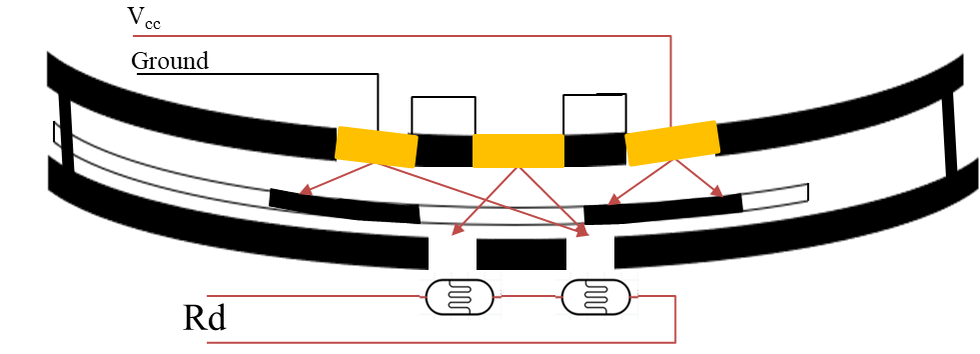

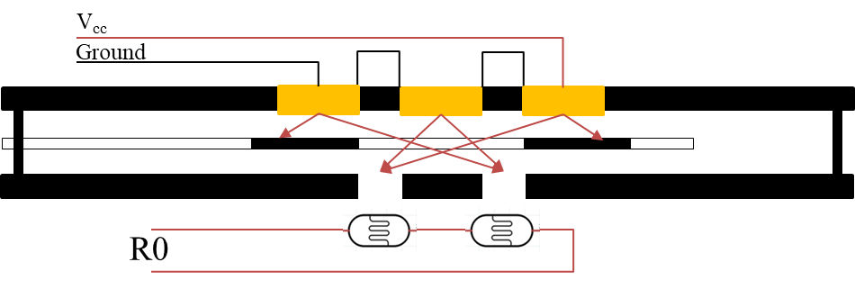

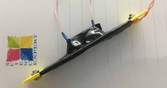

 The LEDs are placed in the middle of the probe. The LED face the LDR. A plastic film (PET from a bottle) is placed between the two probe's supports. A dark mask limits the surface of photoresistors expose to the light. This plastic film is fixed on one side only, which allows sliding during bending. The device is supposed to be symmetrical and the two photoresistors give a final resistance of [R0].
During bending, the optical path of light from the LEDs is changed and it changes the exposure intensity of the photoresistors. The sliding the intermediate mask also modifies the exposure of the photoresistors. This sliding provokes an amplifying effect. The higher the bending, the higher the resistance [Rd] will be.
Since photoresistor has short response time (around 50 ms), the inertia of the probe is due to the plastic properties of the probe.

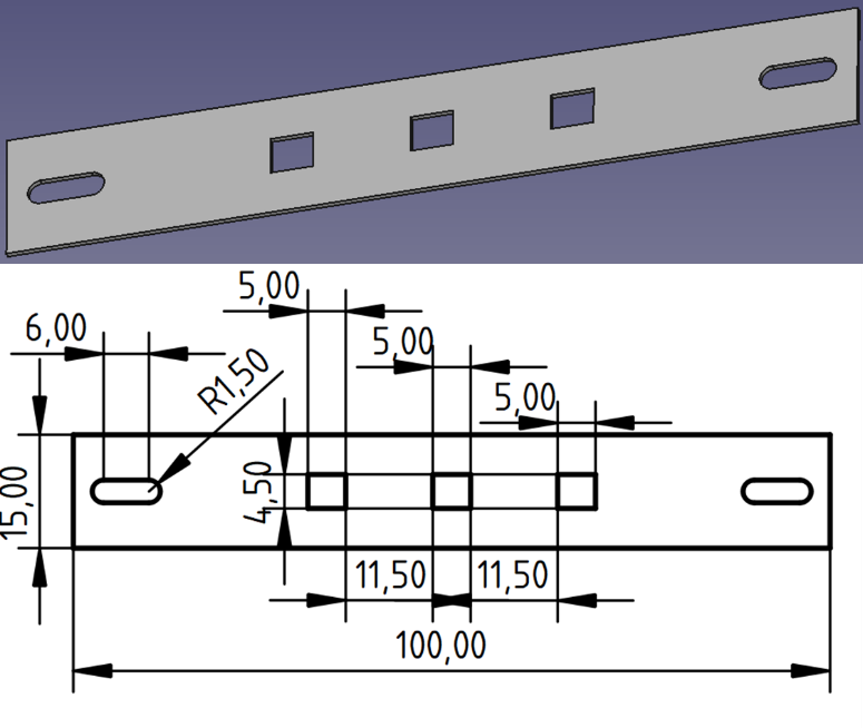

LED strip is 0.7 mm thick in PLA. Our LED strip is made up of a set of 3 , 4x4 mm, LED blocks. They can be cut apart and the separation between blocks is 11 mm. Schemas below gives the dimensions (in mm) of this LED strip:

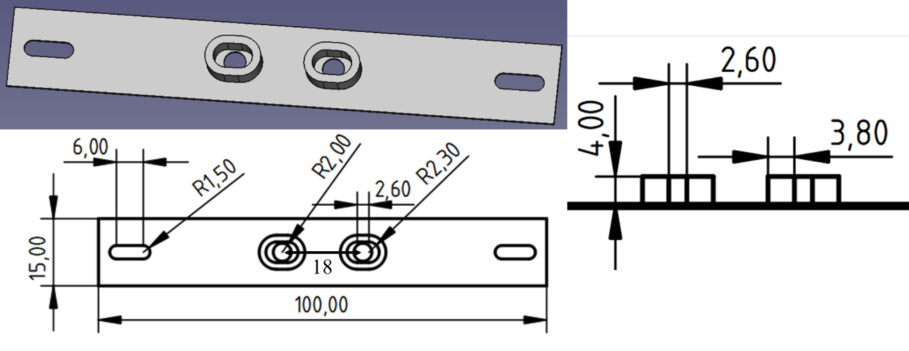

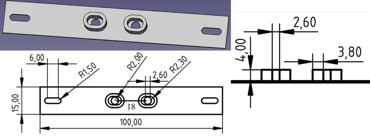

The LDR Strip
The LDR strip is 0.7 mm thick in PLA. The strip of photoresistors is design for the symmetry that we have mentioned. Propagation of light to the surface of the photoresistor is done through a hole 2 mm diameter. Schema below give the dimensions of this LDR strip :

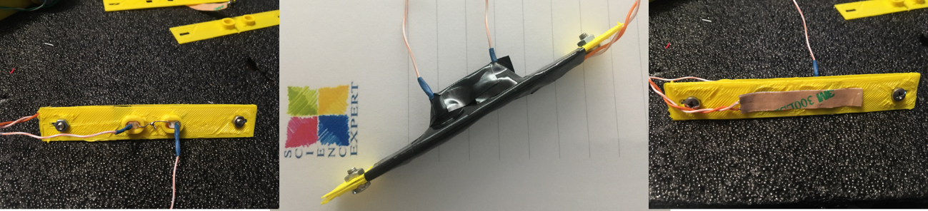

The LDR are fixed on its strip with the translucent epoxy glue. The two LDR are connected in "series" mode. All the assembly is blocked by the two M3 screws and nuts.
At the end, the final device is isolated from outside ambiant light by a black adhesive tape for electrical application :
