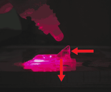

Theory:
Light will enter the horizontal line. It is fully reflective when it meets an inclined surface (intersection between solids and gases).
When I put a drop of water on this point. It will no longer be fully reflective
As shown in the 2nd picture
Teardown:
We will need to get the prisms and LEDs in the optical mouse
As shown in the 1sti picture

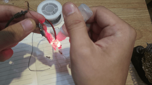

Experiment:
I stick the light sensor to the lower part where the light will reach. Attach the LED bulb at the top
As shown in the 3rd picture

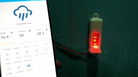

Step 2: Finish
Use light sensor DO pin to connect to MCU (arduino, raspberrypi, esp8266 ...)
As in the picture I linked it to Esp8266 and brought it to my home assistant. This type of sensor will not rust like conventional sensors.
