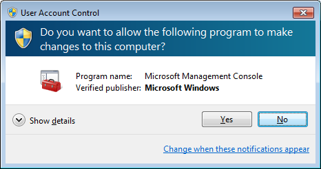

Step 1: Fully Disabling UAC.
User Account Control has no advantage to an embedded Windows PC. In fact, a normal use PC is hindered by its annoying limitations. Once a user is responsible and doesn't install questionable software and has a good antivirus package, UAC is simply not desired.
To fully disable UAC, press the Windows key and R, then type cmd. If you do not have administrative rights then you will have to run cmd.exe as the administrator.
Copy and paste into the cmd window the 4 following pieces of code then press Enter after each then reboot after the last one.
reg.exe ADD HKLM\SOFTWARE\Microsoft\Windows\CurrentVersion\Policies\System /v EnableLUA
/t REG_DWORD /d 0 /f
ConsentPromptBehaviorAdmin /t REG_DWORD /d 0 /f
ConsentPromptBehaviorUser /t REG_DWORD /d 0 /f
/v EnableInstallerDetection /t REG_DWORD /d 0 /f
