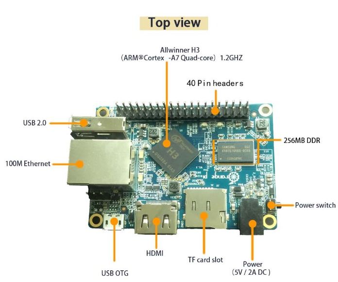

Here's how to get GPIO working in Python on the Orange Pi One.
Note. The GPIO pins on the Orange Pi One are flipped 180 degrees compared to the Orange Pi PC version or a Raspberry Pi!

The way the pins are referred to are slightly different to a Raspberry Pi, they are named "ports" & "connectors".
UPDATE 03/05/2016: The new armbian images no longer export the gpios to /gpio_sw. See the above image for the port names. Image Credit: http://forum.armbian.com/index.php/topic/759-tutor...
For example pin 29 (BCM05) is port 'PA7'
To test, connect an LED to pin 29 through a 300ohm resistor then to the ground. (see diagram below)
