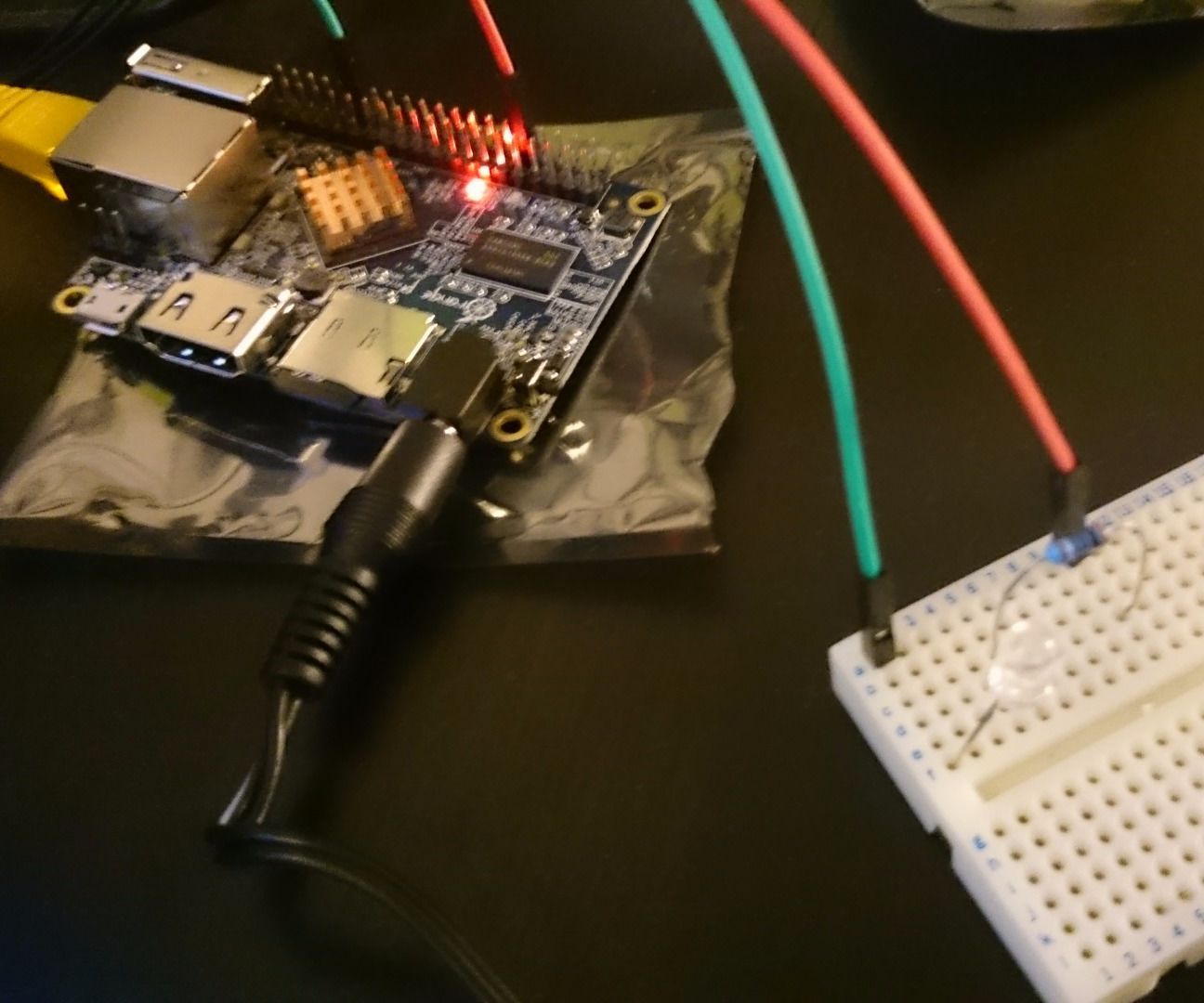

Introduction: Orange Pi One Setup Guide
The Orange Pi One is a £10 computer similar to the Raspberry Pi. This guide will help you setup your Orange Pi One similar to that of Rasbian on the Raspberry Pi. I will assume that you have all the necessary peripherals (mouse, SD card, etc..)
The image for Raspbian for the Orange Pi One from the official Orange Pi site is buggy. Its been built for the Orange Pi PC and doesn't take into account the changes in hardware. When I tested it I've had lots of problems.
So I've been working to setup my One as close to a raspberry pi as possible. So after some research I found that folks at Armbian have addressed these problems. Armbian is Debian 8 compiled for ARM processors.
